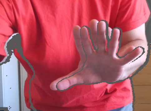

I’m finding that the video and depth seem to be misaligned using Depthkit v0.5.4 #b15a. I’ve used DK before and this did not happen. Recently trialed the new Azure Kinect (and upgraded my license to Pro) and now it seem’s to be misaligning. I’ve used a Kinect v2 as well - same problem. Also evident on a second computer. Doesn’t seem to be evident in the Azure software. Is this something that can be fixed or anyone else has experienced? I feel like it’s making my recordings look bad - or did it always look like this?

  • If you have the depth range set to maximum, you may be seeing a color depth shadow. This can look like a slim outline in your Depthkit capture. It is a characteristic of the depth sensor that can appear like a double image. This behavior can be seen in the image below. It is the nature of the sensor and if this is what you are running into, I recommend adjusting your depth range. Then we can see your capture more clearly to evaluate.

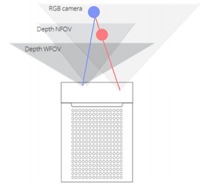

  • In addition, some Azure Kinects are reported to have a slight misalignment between the color and the depth, especially when more than 3 feet from the sensor. We are currently investigating the issue, and I also recommend that you check out details here as well.

Ahhh thanks @jillianmorrow… yes, the issue raised in that link definitely seems to be what’s happening - with the colour info slipping slightly over the edge of foreground objects and onto the background. Looks like it’s the Azure then
Psicon_Lab Ben Neal #4
This would explain some odd visual effects I’ve noticed as I presume all the pixel colour data is slightly offset…
