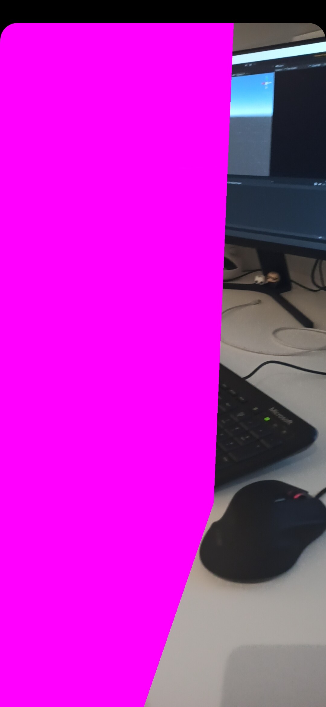

I am trying to make an AR app with Unity using Depth Kit.

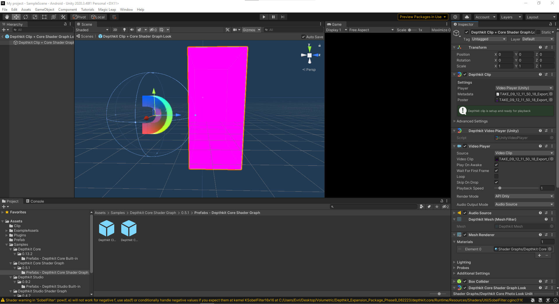

While everything seems to work in the editor, as soon as I build the project, the video player shader fails to compile and inside the app shows a purple box. Then in the editor the shader is also rendered as a purple box. To get the shader working again (in the editor) I have to re select it from the “Failed to compile” shader category.

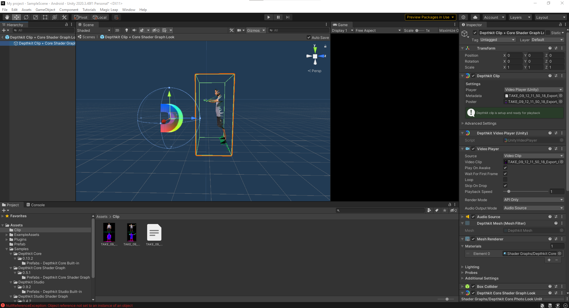

  • Can you also share screenshots of how your Depthkit object is configured in the Inspector?

  5. Photos
On shader the path is: Failed to compile - DepthKit - Core - DepthKit Core Photo Look Build in RP

One other note: My team also pointed out that the pink/magenta volume can appear if the incorrect look is applied to the Depthkit asset. This can happen if:
  • The Built-in Look is applied to a Depthkit asset in a project using the Universal Render Pipeline (URP) or High-Definition Render Pipeline (HDRP).
    *The Shader Graph Look is applied to a Depthkit asset in a project using the Built-in Render Pipeline.
  • Both Built-in and Shader Graph looks are applied to a single asset.
