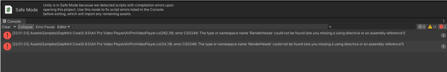

Hello, I’m using Depth Kit 9.0 and everything was working great in project. I am trying to test with Quest 2 and getting link working. . Somehow in the process either the xr plugin or oculus plugin did something that was a conflict for Depth Kit and now I’m getting renderheads errors in safe mode, and player errors and unable to find prefab in regular mode. Any thoughts to troubleshoot?

That error looks like AVPro is not being found by Depthkit. If you are using the AVPro player for Depthkit, then you’ll need to ensure the AVPro plug in is also present. AVPro is a separate add on available from RenderHeads that offers superior video playback to Unity’s built in Video Player.
Which version of AVPro are you using? Perhaps you are still using AVPro 1 or do not have AVPro installed.
As of Phase 6 we are exclusively supporting AVPro 2 - see the release notes here

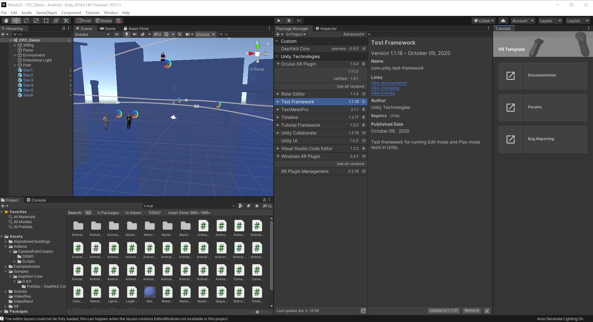

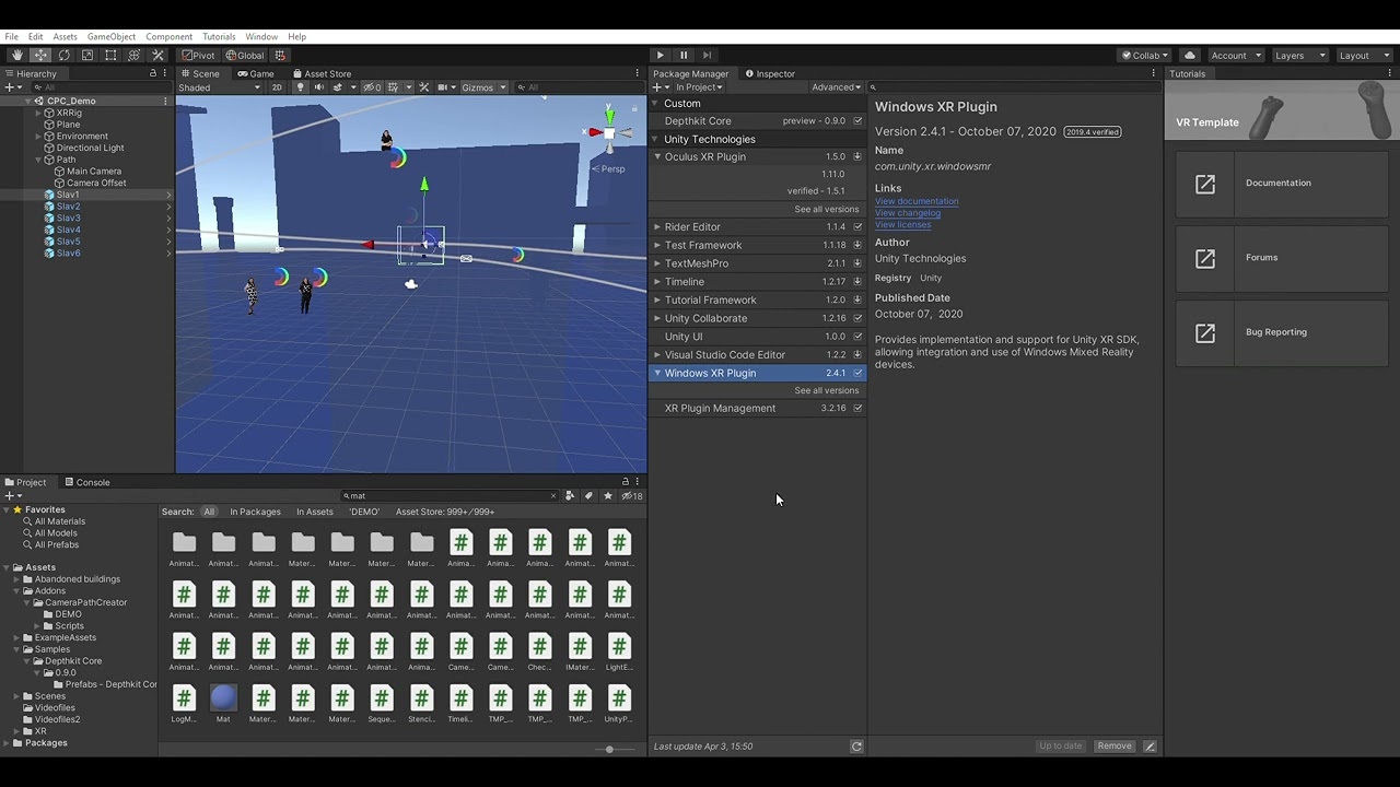

Hi @James. The problem is that I started the project as a 3Dfile, everything was working fine and then I installed plugins for xr and the video player was removed and then the file now has to be in Safe mode. There was a conflict in the pipeline with something. I tried reinstalling Core plug in and it doesn’t work. I started a new file from scratch with the VR template, then followed the quest tutorial on the site for settings, and there is no conflict, but in play mode doesn’t show up on the link on the quest 2 so not sure what’s happening.

Hi @James

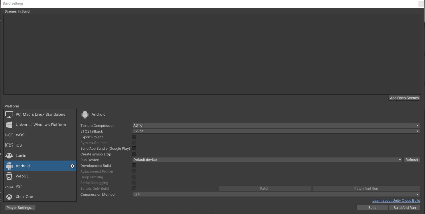

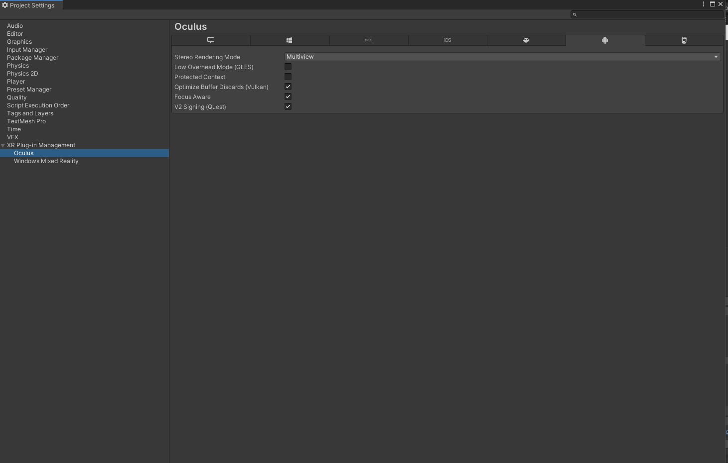

Here’s a screen recording. It didn’t capture the screen shots of the build settings so I’ll upload those here too.
James James George admin Staff #10
Hi @SlavicaCeperkovic Thanks for posting - I’m not able to understand exactly the error you are encountering from the screen recording and settings. Can you point me in the direction of what you are seeing is not working here?

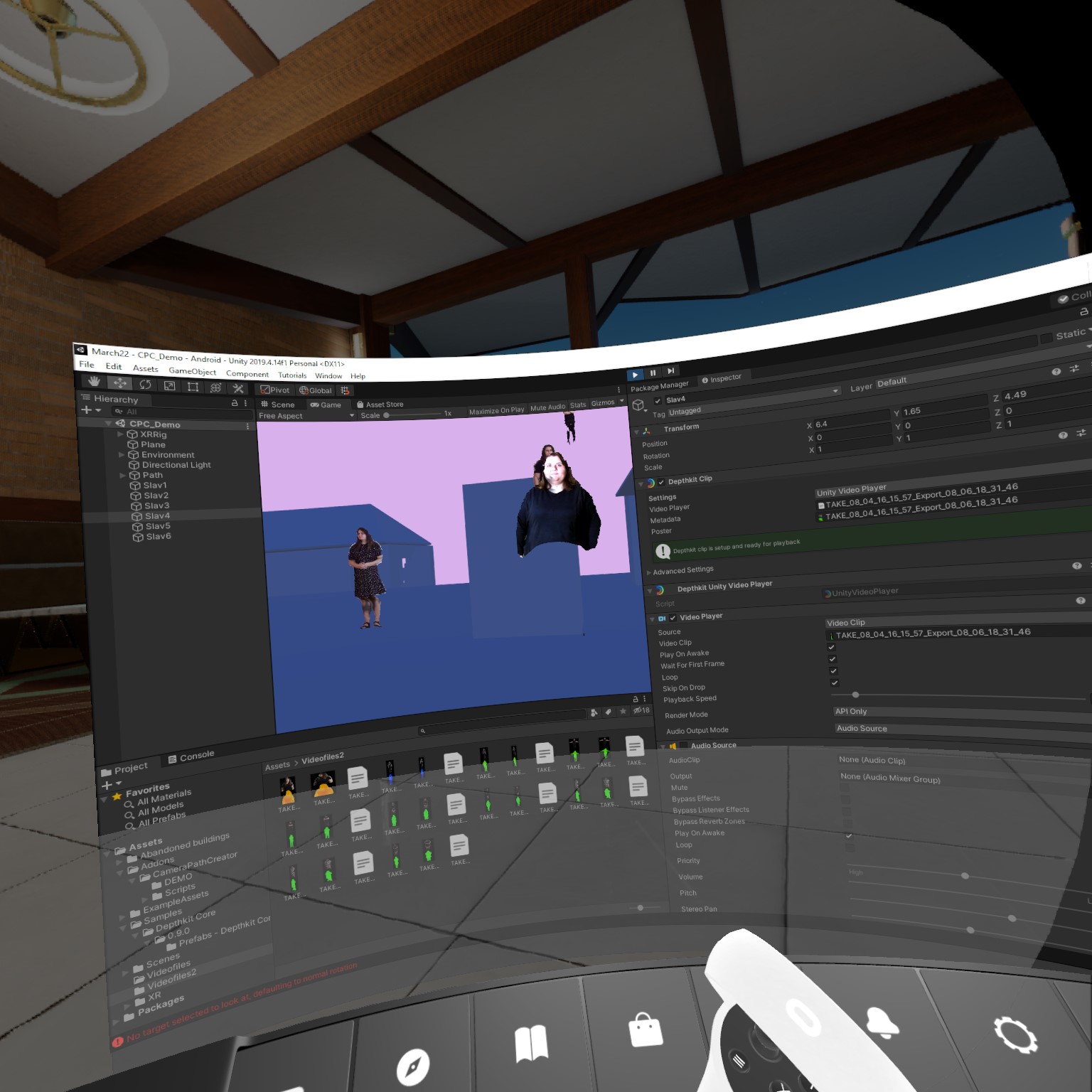

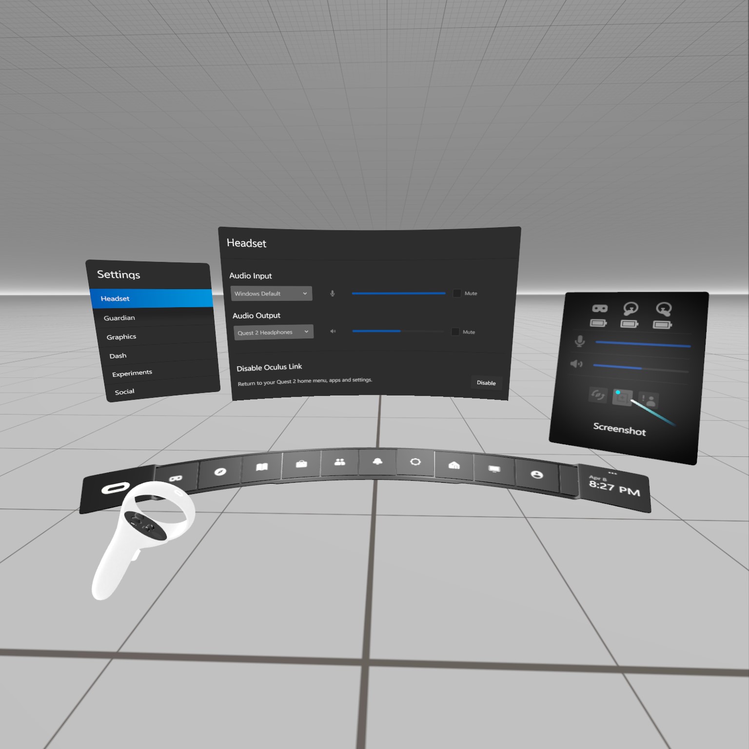

Hi @JamesGeorge . I’m trying to figure out the setting in the unity file to make it work in quest 2.
I can get it to play back in a screen but not as an immersive VR testing with the play mode in unity. Here’s a screen shot of what i mean
James James George admin Staff #13
From the screenshots, it appears you are encountering issues with building from Unity to Oculus Quest 2 - I’ts not clear if you are trying to get it to run with Link or natively on the Quest.
Since this is a general Unity question that doesn’t seem to be an issue specifically with Depthkit Plugin, please look to the documentation for those various workflows.
