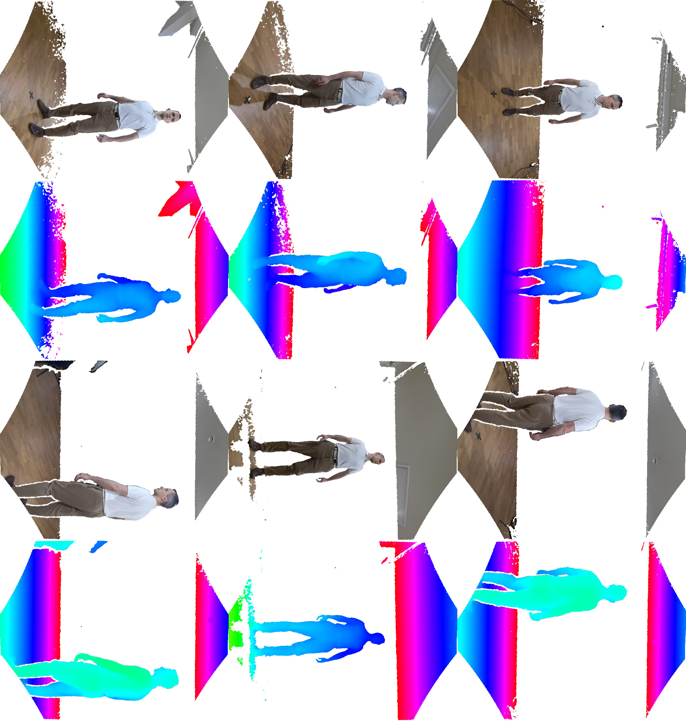

I exported a sequence with standard settings for Multi Sensor PNG out
and the Resolution of this (4512x1184) for all 6 Sensors in one PNG File
Then I followed the description how to transform it into a two row PNG with the example Python Script which is download able … and the resolution changed to 2256x2366
The uploaded picture has the background removed that is the only change it did in this example?

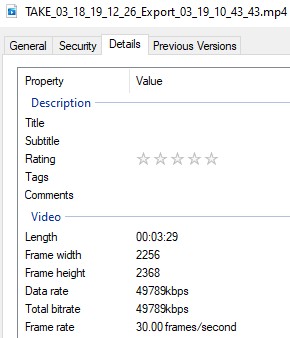

… and then I used the example Code for FFmpeg commando line transcode into the MP4 file
and the MP4 contains all 6 sensors in a resolution of
Video resolution
so somehow each sensor which was recorded each in
RGB 2560x1440
and
Depth Resolution narrow 640 x 576
Azure Depth Resolution
So it looks to me that there is an reduction of the used pixel ?
or do I miss understand something in the process ?
