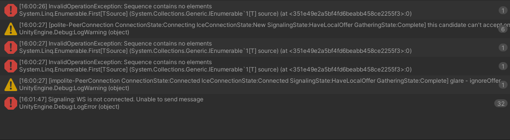

One of your errors says that WS [Websocket server] is not connected. Unable to send message. This could also be caused by connectivity issue between the sender/receiver and the server. We have run into similar issues when trying to connect via a remote server from a network which wasn’t configured properly (NAT, firewall settings, etc.). Have you tried connecting to the same server from the sender and receiver locations using the Bi-directional Example that comes with the Unity Render Streaming Packages? Do you get the same errors?
TalisReks Talis Reks #6
Sorry about the WS connected error! I sent the wrong print to you! The right one is above! The signaling server is in fact opened, but the other errors happen aswell!

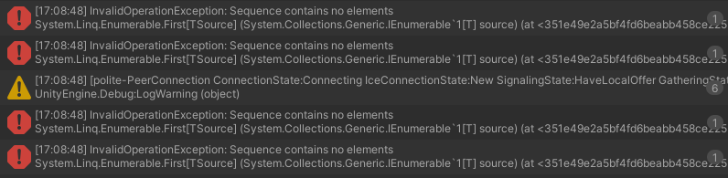

The real print is the one bellow:
@TalisReks We haven’t seen this error before - Can you post the full error message that appears when you select one of the errors in your screenshot?
TalisReks Talis Reks #8
Sure. Here is it. I am uploading it to the google drive again, in a folder called 28-06
https://drive.google.com/drive/folders/121xfTcEpxg2A07JniCFVeYEB64uT-5yg?usp=sharing
Just for you guys to know: on the google drive link that I firstly sent, there is a log which is showing a NullReferenceError. Along with this “Sequence contains no elements”, these were the two main errors that were happening when someone tried to connect as a receiver. And the NullReference one refered to a method called SetTransceiver
