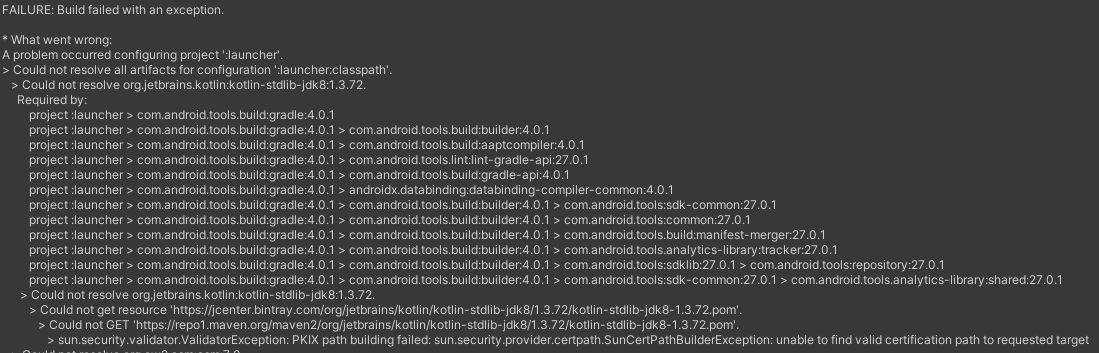

But build failed with the following error message.
It seems like the mismatch of android sdk. But I’ve already install that Unity recommended.
I’m currently using Unity 2020.3.44f1 + Depthkit Unity Extension Phase10.
Does Phase10 still support Unity 2020.3 ?

The tutorial and documentation were created using the Phase 8 version of the Depthkit Expansion Packages for Unity, which itself was released for use with Unity version 2020.3. I will send you a download link to the Phase 8 version to try.
More recent versions of Unity like 2022.3 require the Phase 10 version of the Depthkit Expansion Packages. I am currently testing to see if there are any issues bringing Unity Render Streaming workflow forward into this Unity version, and will let you know what I find.
@ChengYunLiu I was able to successfully validate the Unity Render Streaming workflow with the following versions:
  • Unity version 2022.3.53f1
  • Depthkit Expansion Packages for Unity (Phase 10)
  • Unity Render Streaming version 3.1.0-exp.7
In performing this testing, I noticed a couple of items in the Depthkit Livestreaming with Unity Render Streaming documentation were out of date, so I have updated them to reflect a workflow using the versions listed above.
I was unable to test on an Android device, but I would start by testing on your side with these versions, and then build the receiver app for Android, then let us know your results here.
