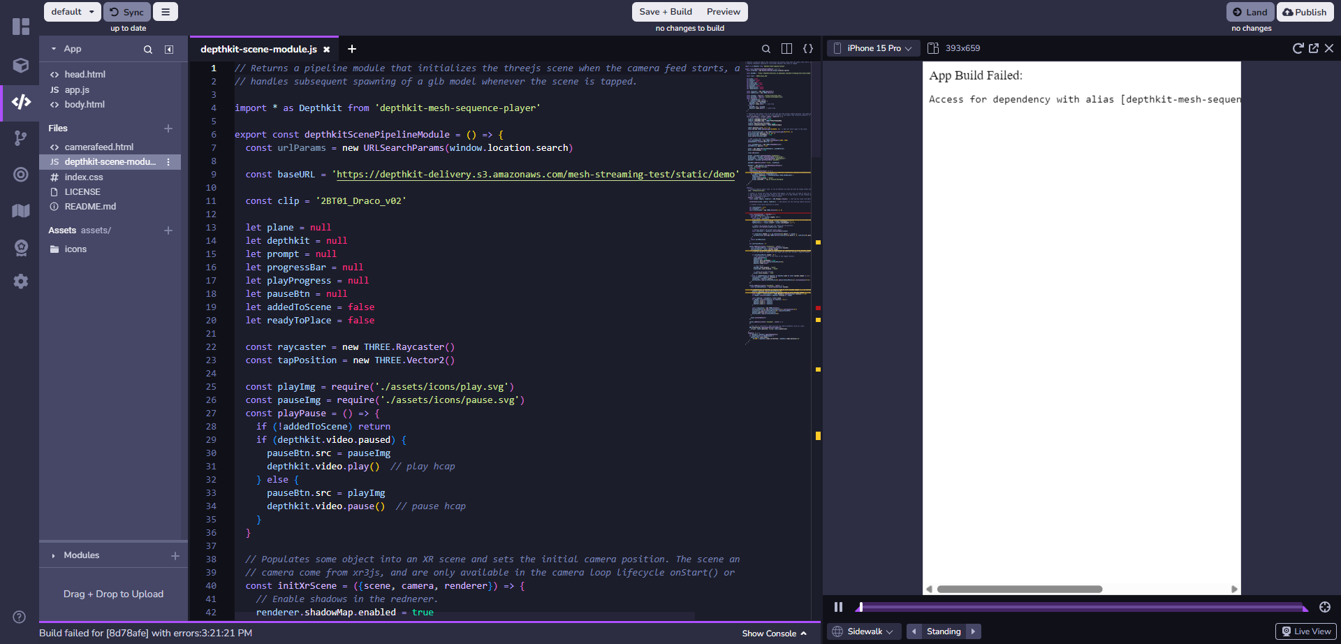

Hi @CoryAllen I am having a similar issue. I have cloned the 8th wall project and I also get the same error.
'App Build Failed:
Access for dependency with alias [depthkit-mesh-sequence-player] does not permit current action’
I can confirm that I have imported the associated module. Would you be able to provide any assistance with getting the base project running?

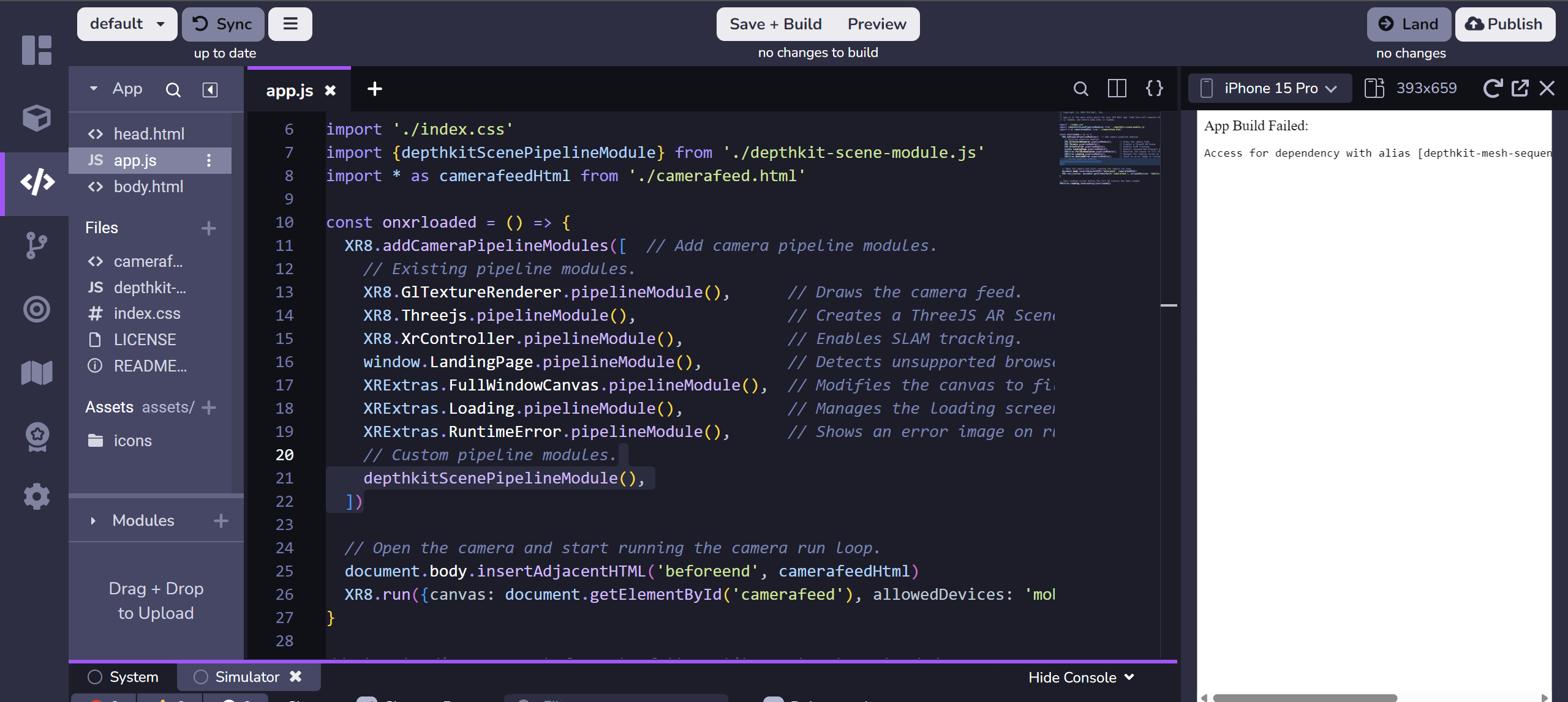

@Cory Allen thanks for this clarification. I am still unable to play the demo asset referenced in the original project. When I launched the project with the QR code I can view the assets. As soon as I clone the project, I get the “App Build Failed” error. I made another project and pasted the lines you provided with resulted in the same error. I also double checked with our IT team, and they have confirmed that the CORs configuration was setup according to the documentation.
CoryAllen Cory Allen admin mod Staff #16

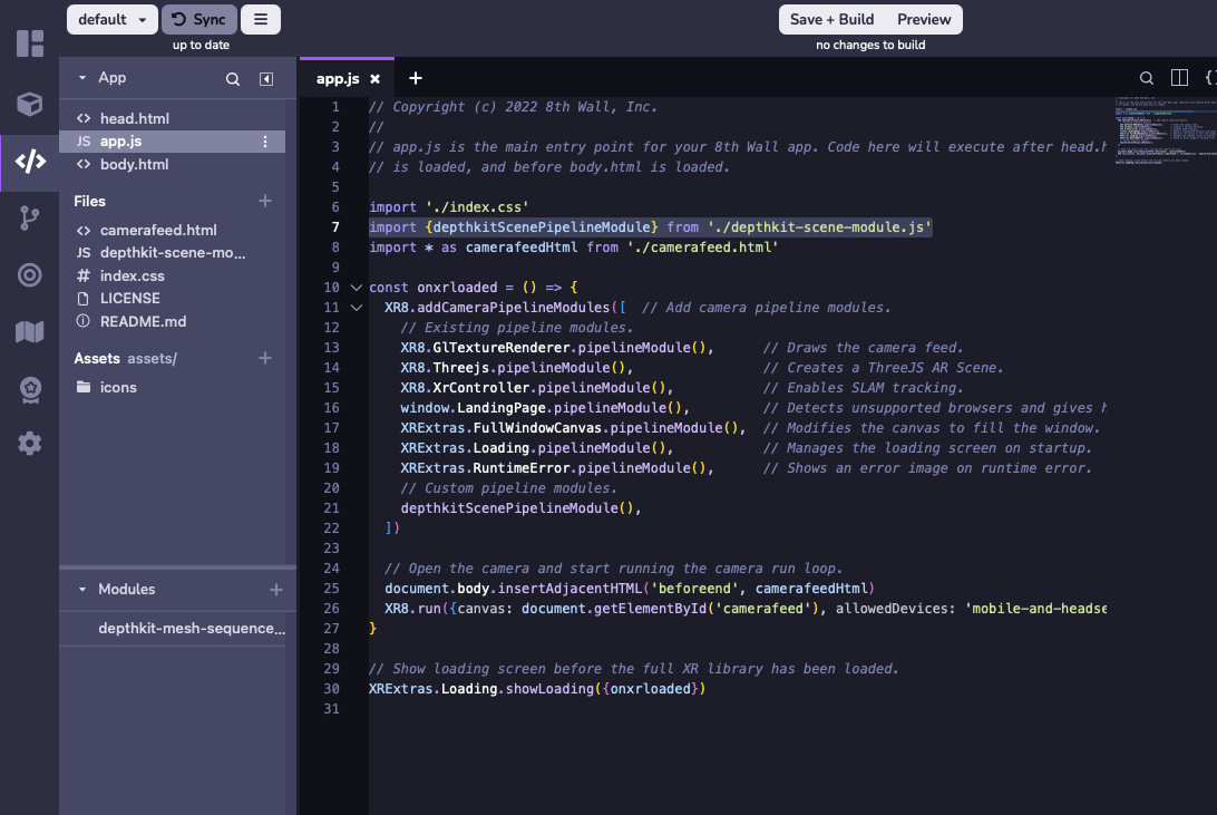

@Cherelle Can you confirm that the module appears in the ‘Modules’ drawer in the left pane? It’s unclear if that ‘Modules’ drawer is empty or just collapsed. If is empty, the module is only imported in code, but the project is not correctly configured with it as a dependency.
Cherelle Cherelle Connor #17
Hi @Cory Allen thanks for that while the Module had an incorrect pinning target. I change it to the latest version and now I am able to get the cloned project to work. Thank you very much for your assistance with this!
