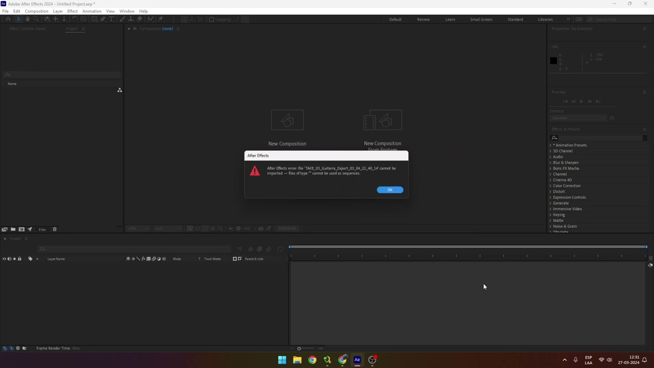

By following the tutorial ( Using Depthkit OBJ Sequences with Depthkit Core, After Effects and Plexus ) and getting to the part of importing the OBJs as 3D files for plugins. After Effects tries to import the sequence, but it always gives me the same error.
I also tried with OBJ as 3d for Trapcode plugin and the same thing happens.

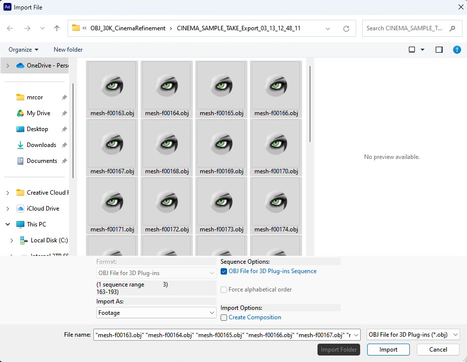

When importing, are you selecting the OBJ’s themselves as pictured below (as opposed to selecting the containing folder)?

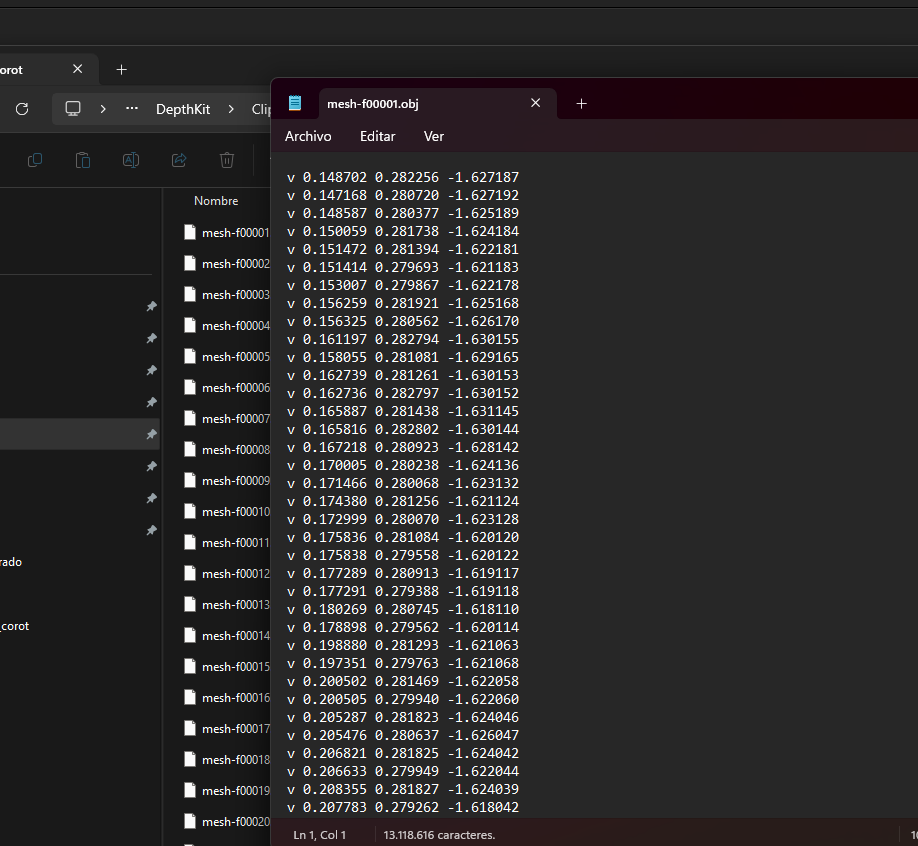

Do keep us up to date with this issue. One possibility which would cause the files to fail to open in After Effects is is that the OBJ’s were exported out of a previous version of Depthkit with corrupted OBJs. You can confirm if this is the issue by opening one of the OBJ’s in a text editor and checking to see if the numbers are formatted with commas (incorrect) instead of periods (correct). This has been resolved in the latest release of Depthkit, so if this is the issue with your OBJ files, you can simply update Depthkit to the latest version, and re-export the OBJ files.

I did the import tests and it doesn’t work, I recorded a video so you can see what’s happening to me.
The way it worked for me is to import but only within the Element 3D Plugin, but with it I lose the features of the new after effects engine. And I can import Obj but only as separate elements, not as sequences.

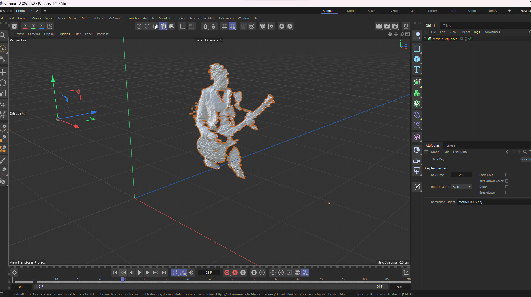

I think it worked for me once, I don’t remember well. But I think that by passing the exported DepthKit sequence through Cinema4d and from there re-exporting the OBJ sequence. But like I said, I’m not 100% sure.
@aldomanetti When I select one OBJ as ‘OBJ File for 3D Plugins Sequence’ as you do at 0:30, I am able to load the entire sequence of OBJ’s into After Effects as one footage asset containing the entire sequence.
Are you able to open the same OBJs in other software like Blender? If not, have you opened them in a text editor to see if they have this issue?

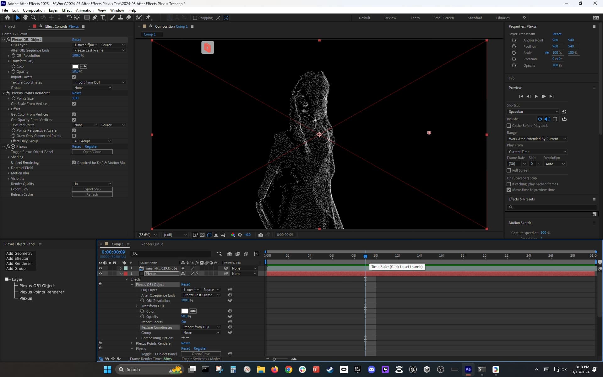

I think I have already resolved the issue. The problem was thinking that natively AfterEffects could import OBJ Sequences, but it is not yet capable, it can only OBJ separately. And when using plugins such as Plexus, Element 3D or Trapcode, they enable the possibility of importing sequences but to be used with those plugins and not with the new 3D rendering engine that After Effects incorporates.
I’m looking for the look that I achieved with this capture that I share, but of course they are independent OBJs within AE.
