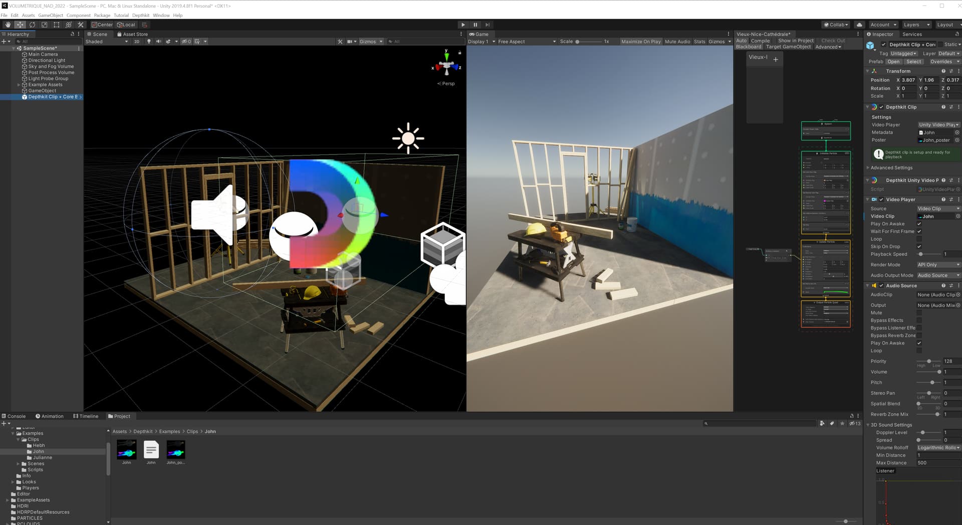

With the depthkit core expansion package installed I was hoping that my depthkit clips would be appearing in my hdrp scene but they aren’t.
I’ve followed the instruction from the getting started with the “depthkit core expansion package” :
How my scene appears:
Any help on making this work would be truly appreciated,
cheers,
Mathieu.

To use Depthkit Core in HDRP, you need to use the Depthkit Core + Shader Graph prefab.
Check out our latest documentation for the Core Expansion here, and specifically where we show how to use Shader Graph which is needed for HDRP and URP.
