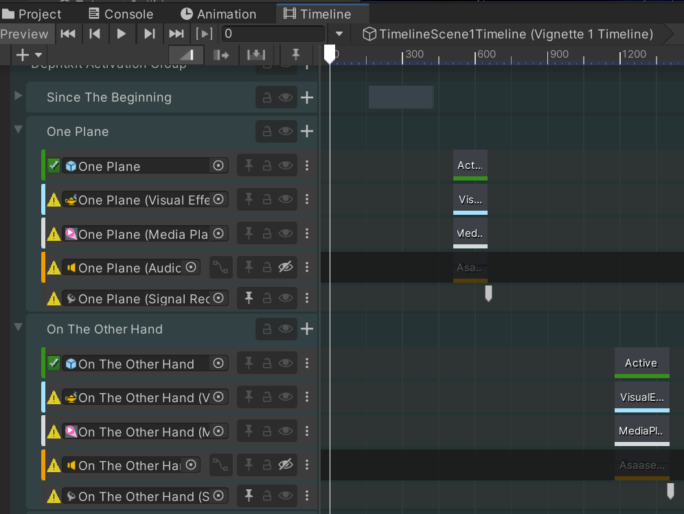

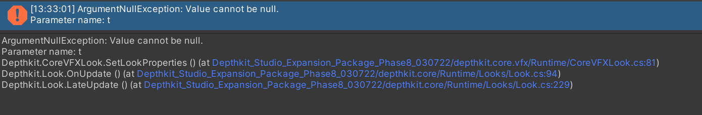

So I am using a timeline and avpro to play 17 dk clips in a sequence and for the most part everything is working fine and all of the clips are playing back. However, 7 of them keep giving me this error both in editor and during runtime, and I believe these errors are also responsible for crashing the quest build as well.
The other 10 Depthkit playback objects were doing this at one point as well, and clicking generating data in the “Depthkit Core Visual Effect Graph Texture Source” solved the issue. However, for 7 of them I generate new data and error stops, then in runtime the error comes back and after exiting the play mode the errors persist until I regenerate the data again. As far as I can tell everything is same between the 10 that are fine and the 7 that aren’t, besides position data and the files video/poster/text files being used in the depthkit and avpro scripts, and that when I hit generate data or playback ends, the 10 that work have their DataWidth and Height reset to 0s in the vfx graph, while the 7 that are giving errors have their DataWidth and Height reset to 1s or 256s. I’ve included screenshots of my timeline showing one of the working clips on top and one of the error clips below it if that helps.
I have been able to get around this in playmode with a script that calls the generate function of the Core VFX graph texture source at start for those seven clips, but the issue still persists when in the editor. Any insight into why this is happening would be great and let me know if I can provide any more info! Thanks!

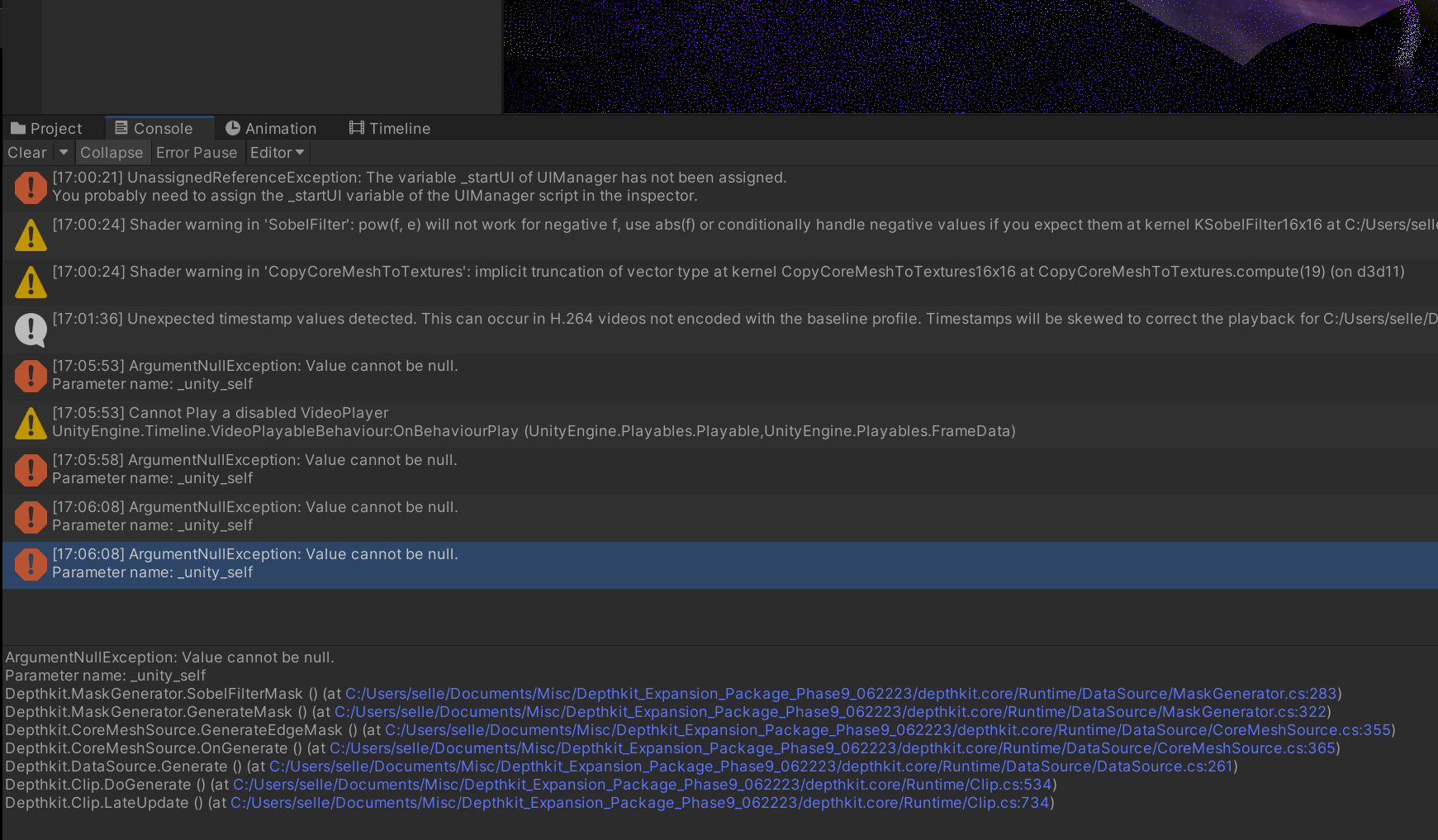

Hey @CoryAllen I’ve upgraded to the new package in one of my projects, but I’m getting a new error now when scrubbing through the timeline and when by timeline loops during playmode/runtime.
I can get it to go away by disabling and re-enabling the depthkit clips in question, but they still comeback from time to time.

Thanks for going through the upgrade path to test the new Phase 9. Sorry to see you are still encountering issues. We haven’t seen this error before, and since there is no strack trace I’m not sure it is directly related to Depthkit
See this Issue in the Issue Tracker
Can you confirm that you are using Unity 2020.3 LTS, which is what we test against? Also if its possible to start a clean project to create a minimal reproduction of the issue so we can see it on our side, that would be really helpful.

Hey James! Sorry for the late reply, I’m in Unity 2020.3.45, and I’ve included a full error log screen cap here as well if that helps.

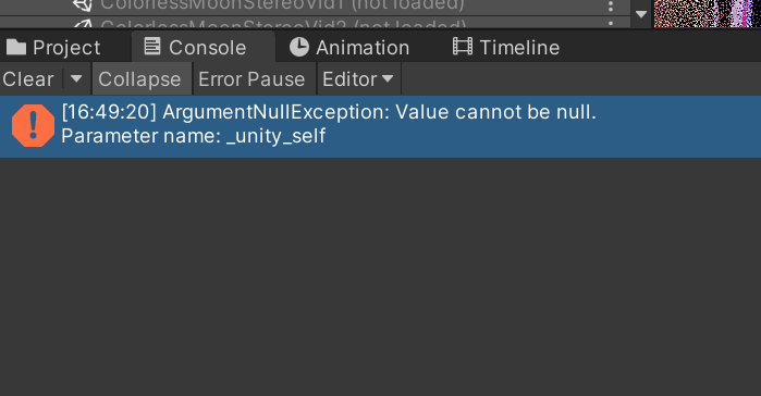

One thing to note, this error is actually happening in a second project I’m working on that doesn’t use AVPro2, only the default Unity video player. I will upgrade the package in my other project that uses avpro2 and let you know how it goes there as well!
@WhittSellers We haven’t been able to reproduce the issue on our side, but after searching around for similar issues in Unity, our team found a thread that seems to indicate that the issue may be resolved by disabling deleting the Depthkit object, and reconstructing it from scratch. If this from-scratch approach solves the issue, this could indicate that it’s related to upgrading the packages in an existing project. Try that and let us know what your results are - Thanks!
Tim Timothy Scaffidi admin mod Staff #13
Hi @WhittSellers, I was finally able to repro this issue, and it is quite odd. It does seem to be related to disabling / enabling Mesh Source components, and some internal state of the Mask Generator seems to be getting corrupted. I don’t yet have a fix for you unfortunately, but at least I can interrogate the problem now.
As a temporary work around, you may be able to get away with disabling just the Look component, rather than the entire game object if that is what your timeline is doing now.
