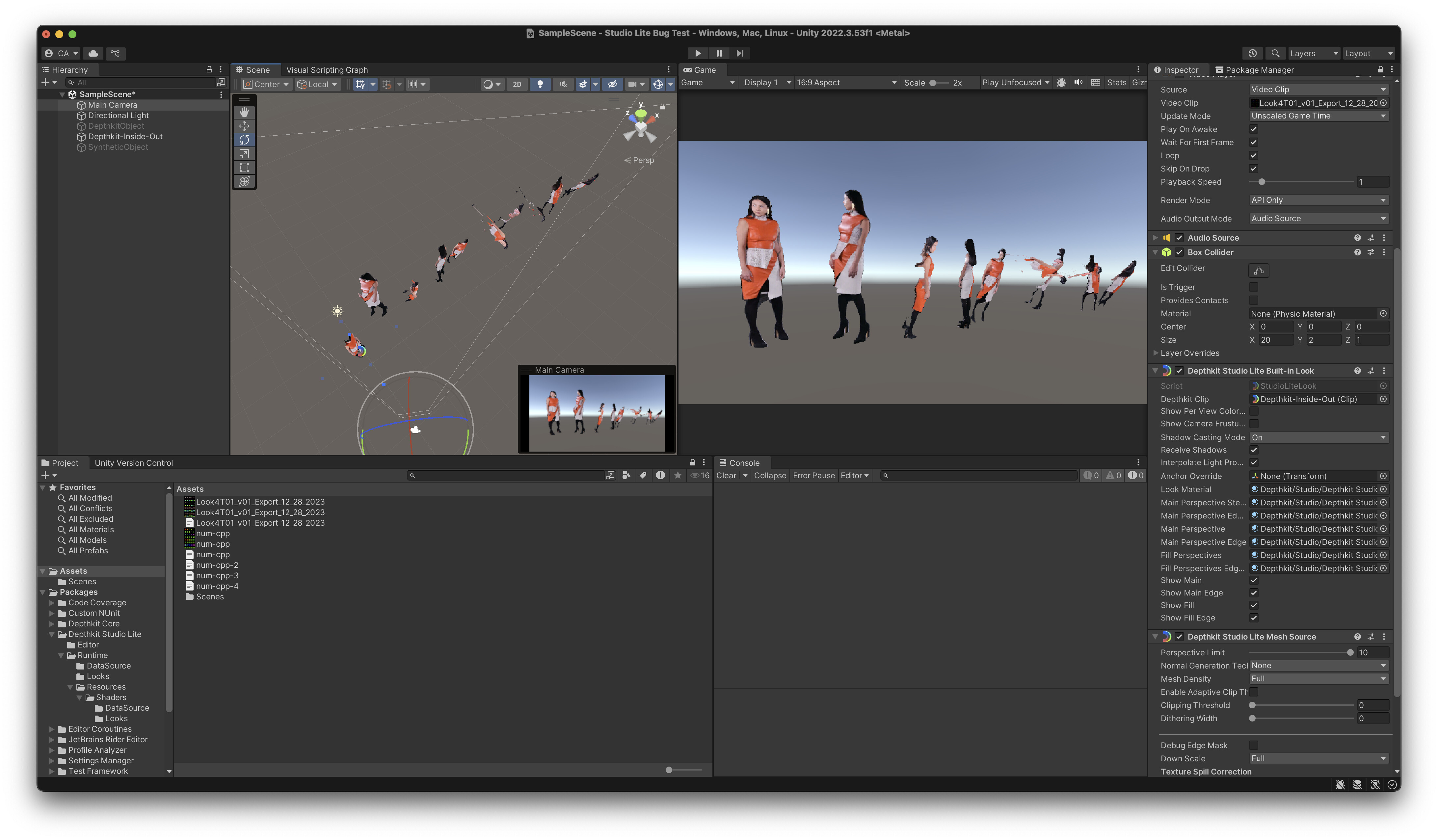

I’ve been using the DK Lite player in Unity with a 10 camera capture video, but only 9 of the 10 perspectives are rendering never the 10th. I can easily see this in action by using the Show Camera Frustum for each perspective - and as my performer walks into Perspective 9 (eg the 10th as first is 0) they dissapear.
Has anyone seen this or had trouble before? Is this a bug or something I’m doing wrong?

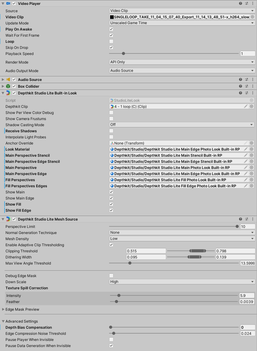

I’m aware the DKLite player hide perspectives based on the camera, but I’ve set the Perspective Limit to 10 - is this inclusive of camera 10? (I can’t set it to 11). I need all 10 perspectives visible - all the time.
Can anyone help? Any advice? Could be something in the metadata?
Here’s the settings

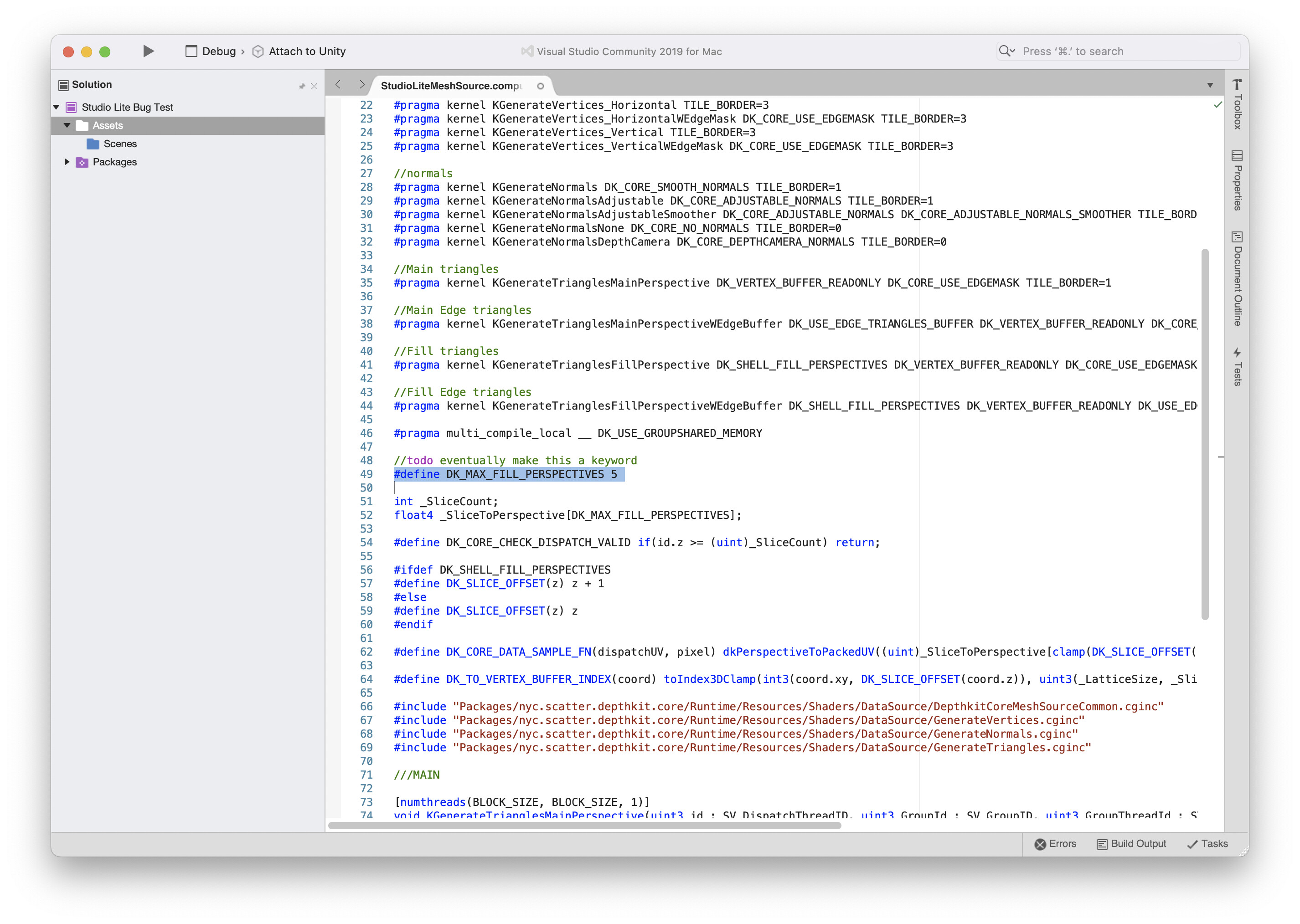

@Psicon_Lab - Apologies for the delay, and thanks for the nudge. We actually just found a setting in the Lite renderer which may be the cause of your issue.
  • In a code editor, open Packages/nyc.scatter.depthkit.studio.lite/Runtime/Resources/Shaders/DataSource/StudioLiteMeshSource.compute
  • On Line 49, change #define DK_MAX_FILL_PERSPECTIVES from 5 to 10
  • Save the modified shader, and refresh the Unity scene.
With this change, I am able to render all 10 perspectives of one of our example assets side-by-side simultaneously.
Let me know if this resolves your issue. If it doesn’t, please do share the Depthkit clip and metadat that you are working with so that we can take a closer look. I’ll keep an eye out.
