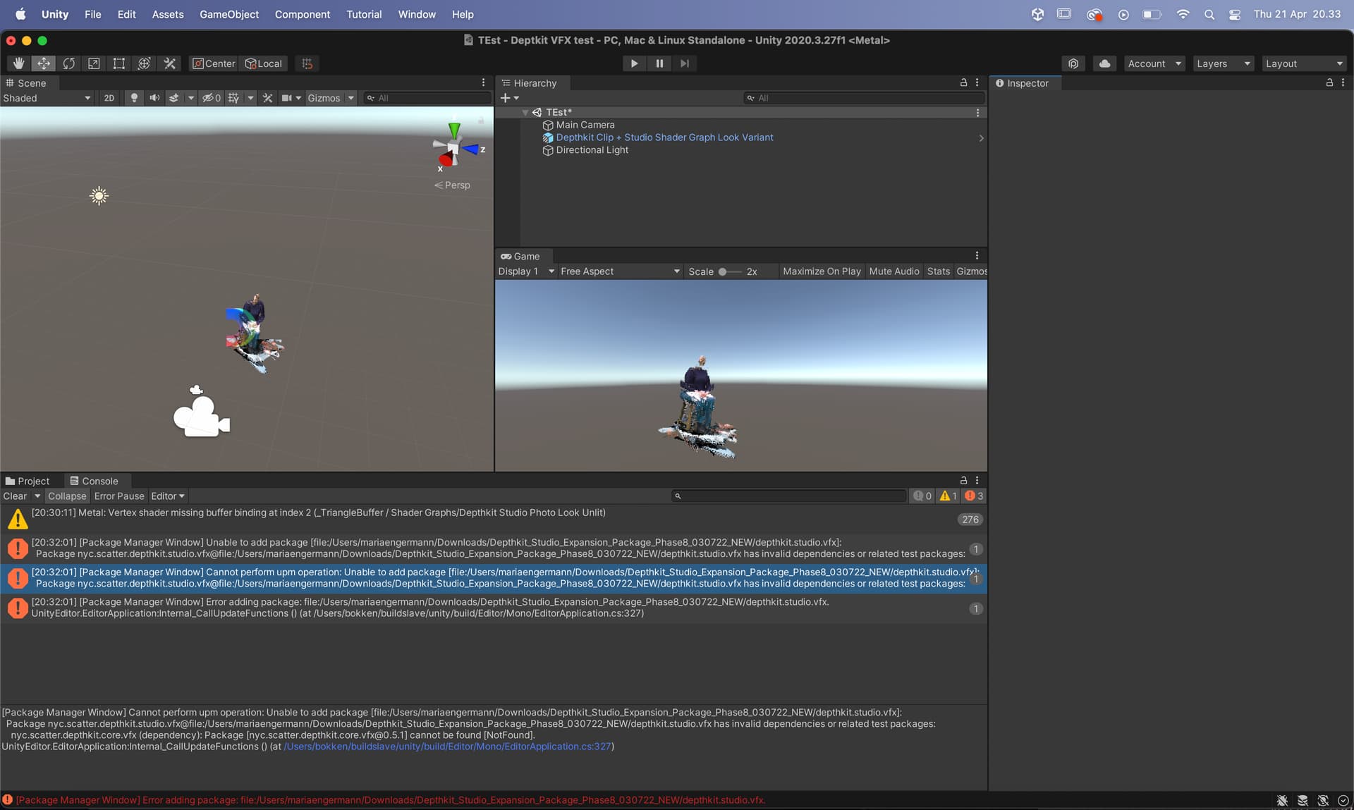

I’m currently having some technical problems within Unity, and I hope you can help us. I’m trying to get the VFX plugin/MyLook to work, and I have been following your documentation Visual Effect Graph
but it keeps giving me this error (pls see attatched pictures). Maybe you or someone from your team can help us out?

Thank you for your reply! I did have URP installed, it was just not visible on the previous screenshot. I tried starting a new project without AR foundation and after installing:
Depthkit Core, Depthkit Core Shader Graph, Depthkit Studio and Depthkit Studio Shader Graph the volumetric video player works - however when I then try to install the “Depthkit Studio Visual Effect Graph” then I get the following errors (see new screenshots).

Can you double check to make sure you have the Depthkit Core VFX graph installed prior to installing the Depthkit Studio VFX graph. The Studio package depends on the Core package for Visual Effect Graph support.

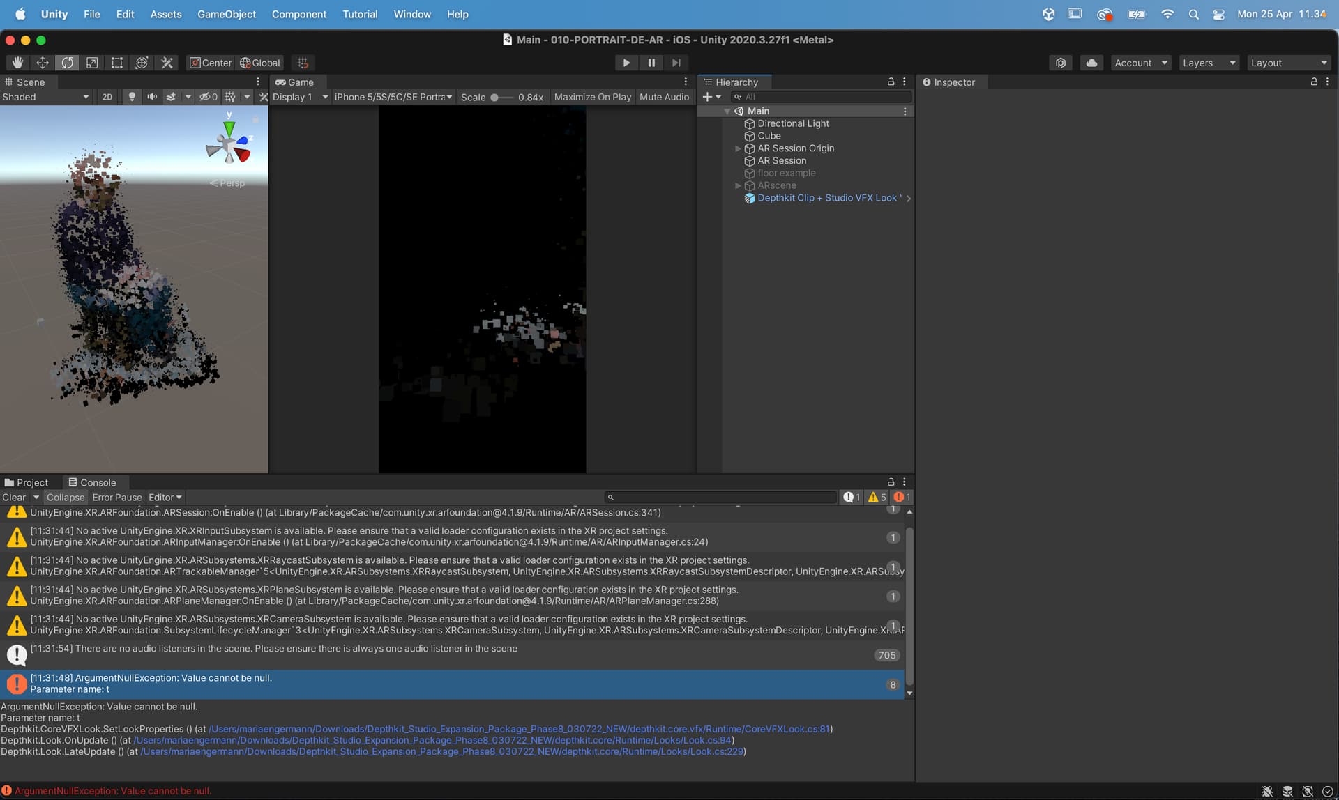

You were right, it seems like it was the correct order that was the core of my problems 🙂 It looks like it’s finally working now! Thank you so much 😃 💙
It still gives me a random error (see picture),is this an error I should be worried about and fix?
James James George admin Staff #5
Great glad this worked!
I don’t know the cause of that error but if things are working as expected you can safely ignore it for now. If you encounter further issues we may investigate to see if that error is a clue.
