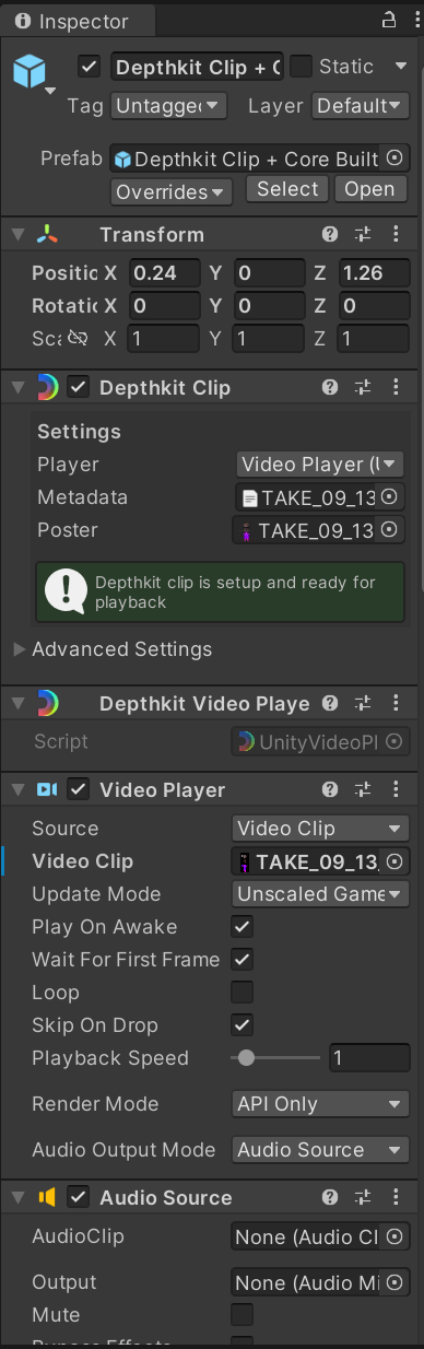

  • Can you also share screenshots of how your Depthkit object is configured in the Inspector?

Screenshots:
Thank you!
