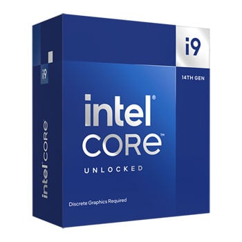

Terence Terence Quinn #9
Thanks Cory.
Is it worth upgrading the current studio rig CPU? It is already processing 10x 1440p @ 30fps with few or no dropped frames. But CPU is almost always around the ceiling of 100% utilisation. The system is already overclocked to a small (to ensure is stability) extent, and Win 10 stripped down as far as possible.
This Tower PC has RTX A5000 not AVA.
Kind regards
Terry
Current vs 14th Gen CPU specs :
Intel® Core™ i9 18 Core Processor i9-10980XE (3.0GHz) 24.75MB Cache
Vs
Intel 24 Core i9 14900KF Raptor Lake Refresh CPU/Processor
scan.co.uk
](https://www.scan.co.uk/products/intel-core-i9-14900kf-s-1700-raptor-lake-refresh-24-cores-32-threads-60ghz-turbo-36mb-cache-125w-ret)
