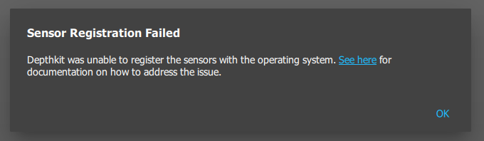

Trying to test femto-bolt on Terry’s main PC (one he used in the studio previously successful captures with Kinect Azure ) but keep getting this error ‘unregistered sensor connected to retry the registration.’ tried all the advice but still wont register? Any ideas how to resolve please ?
@Terence - Can you provide more information:
  • When running the Register Sensors script, were you prompted to give the PowerShell script administrative privileges, and did you indeed click ‘Yes’?
  • The contents of the Depthkit console when you try to run the Register Sensors script.
  • The contents of any command line windows like PowerShell after running the script.
There may be error messages in the above which could help us identify the issue.

Thanks Cory > When I click ‘Register Sensors’ it goes direct to ‘Sensor registration failed’ so no opportunity to access the Register Sensors script or any other options to resolve ?
Terence Terence Quinn #5
Connected a couple of cams to the Orbbec view and seems to have resolved the registration issue
Glad to hear that the sensors are now registered using Orbbec Viewer.
For future reference, PowerShell script which comes with Depthkit to register the sensors can be found in the folder that Depthkit is installed in (C:\Program Files\Depthkit by default) and is named obsensor_metadata_win10.ps1. You may need to start PowerShell as an administrator and then point it to this script and run it in order for the registration to be successful.
