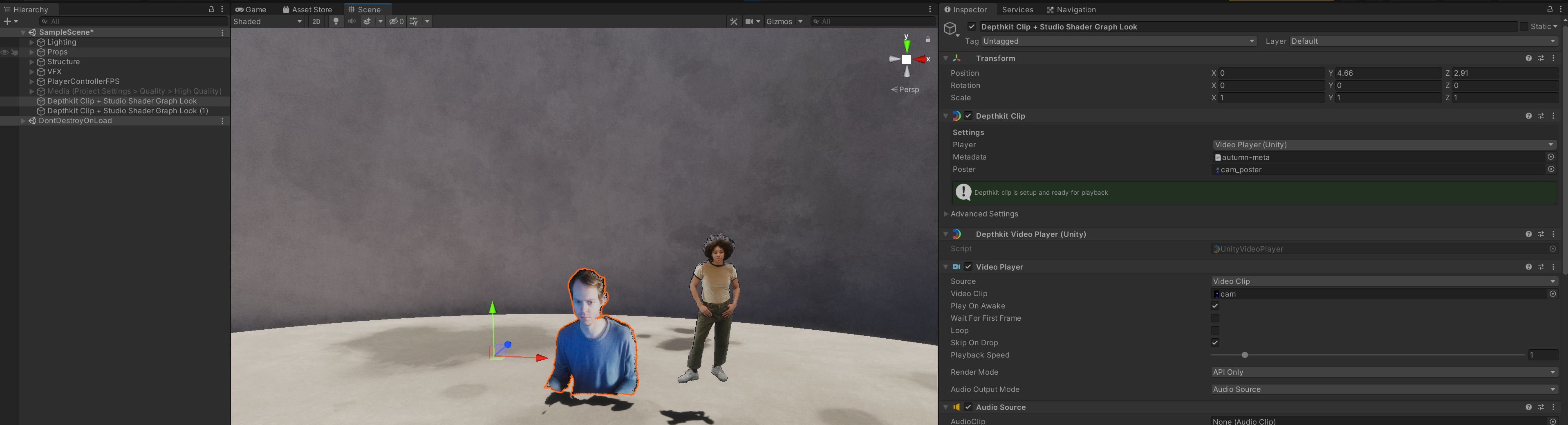

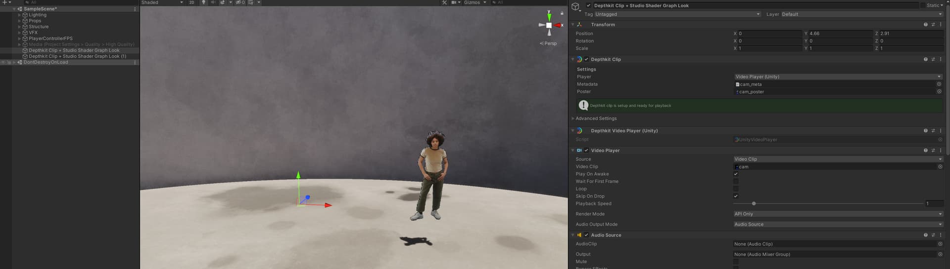

Hello,
I was able to create a Unity 2020.3.33 project with the HDRP pipeline and see the sample autumn data work correctly.
However when I export my clip into Unity, nothing appears. An interesting note is that if I use the autumn meta data, I can see my clip and it does play though it doesn’t play in full
Is there something I should check for in my export settings?

CameronDonley Cameron Donley #3
Hey Cory,
  • I recorded the asset using depthkit 0.6.0 app with 1 Azure Kinect DX Camera
  • I’m using the same prefab Depthkit Clip + Studio Shader Graph Look for both. Here’s me with my meta data
Forum won’t let me have two screenshots in the same post so I’ll make another post with the vs screenshot
  • There are no errors in the console

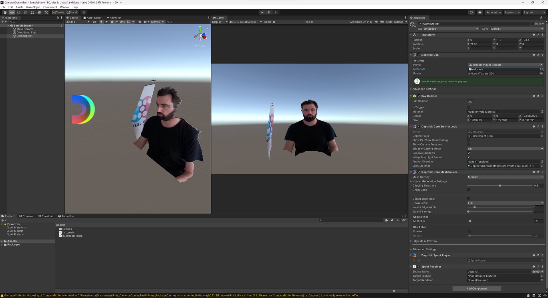

@CameronDonley I took a look at the metadata you provided, and it appears to be working.
One thing our team noticed is that in your screenshot, you have a Depthkit Studio mesh source and look applied to your Depthkit Core clip, and although it may render your asset, artifacts may appear and performance may drop. Be sure to switch out the components with their Depthkit Core counterparts to avoid these issues.
CameronDonley Cameron Donley #8
So I was able to get this working in a new project that was using Core instead of HDRP. Is there a reason why it wouldn’t work with HDRP?
