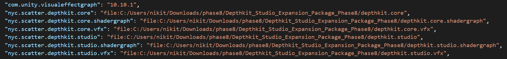

I have a Unity Project that has these hard-coded paths to a Unity Depthkit Core Expansion (Phase 8)
I’m able to download them with a Phase 9 download by re-configuring those paths appropriately for my machine.
Side Note : I can’t seem to do the same with a Phase 10 download because there is no depthkit.core.vfx or depthkit.studio.vfx folders there.
By re-configuring those manifest.json paths I’m able to open the Unity Project but… the videos placed in the Video Player > Video Clip are no longer accepted and an errors like the one below gets output in the console :
