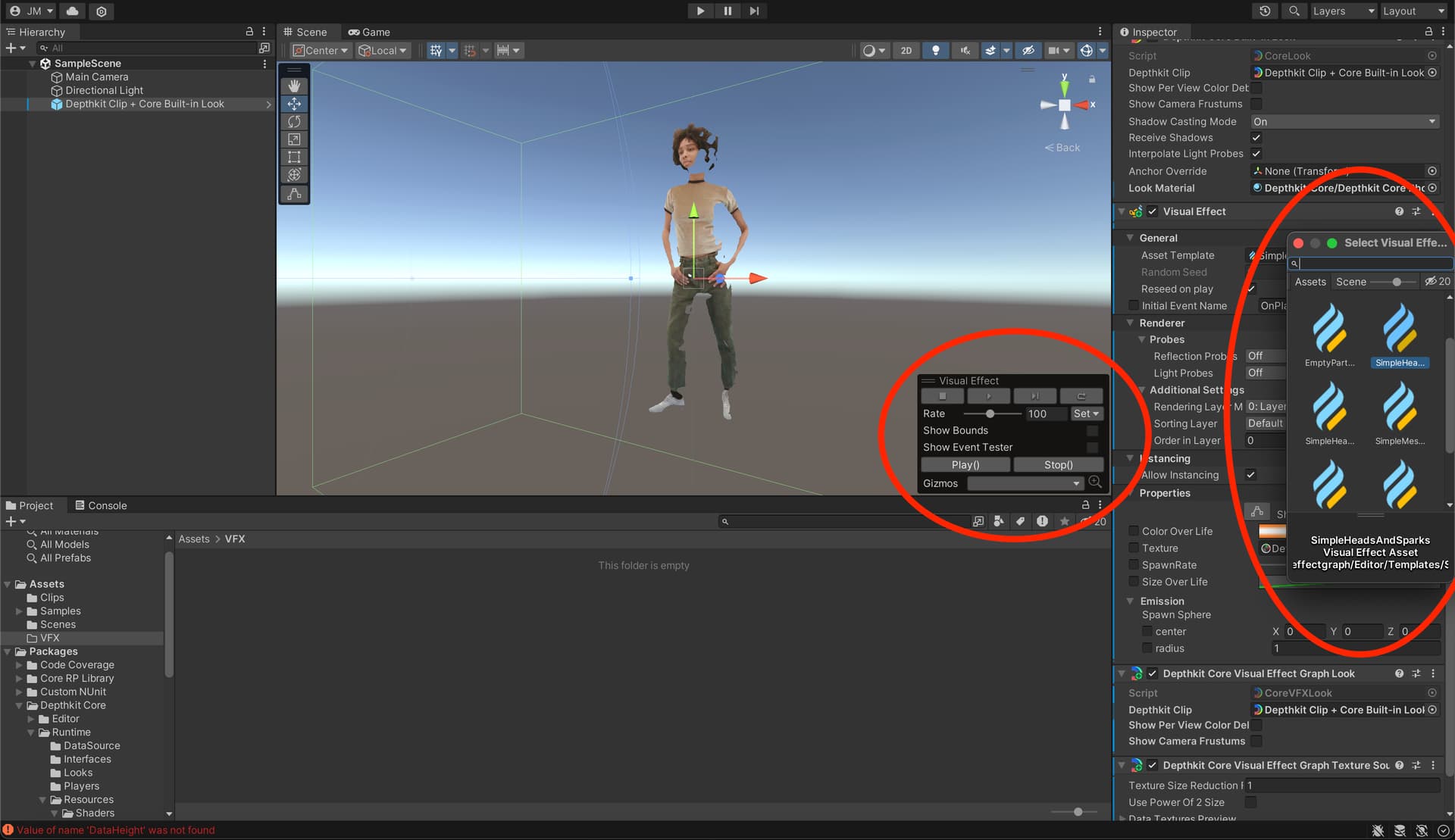

Thanks for your quick response. Unfortunately it isn’t working yet. After doing what you said I have the following problems in no particular order:
  • The VFX demo’s are not working, I can see them in the list, but while using the play() and stop() buttons I don’t see anything happening.

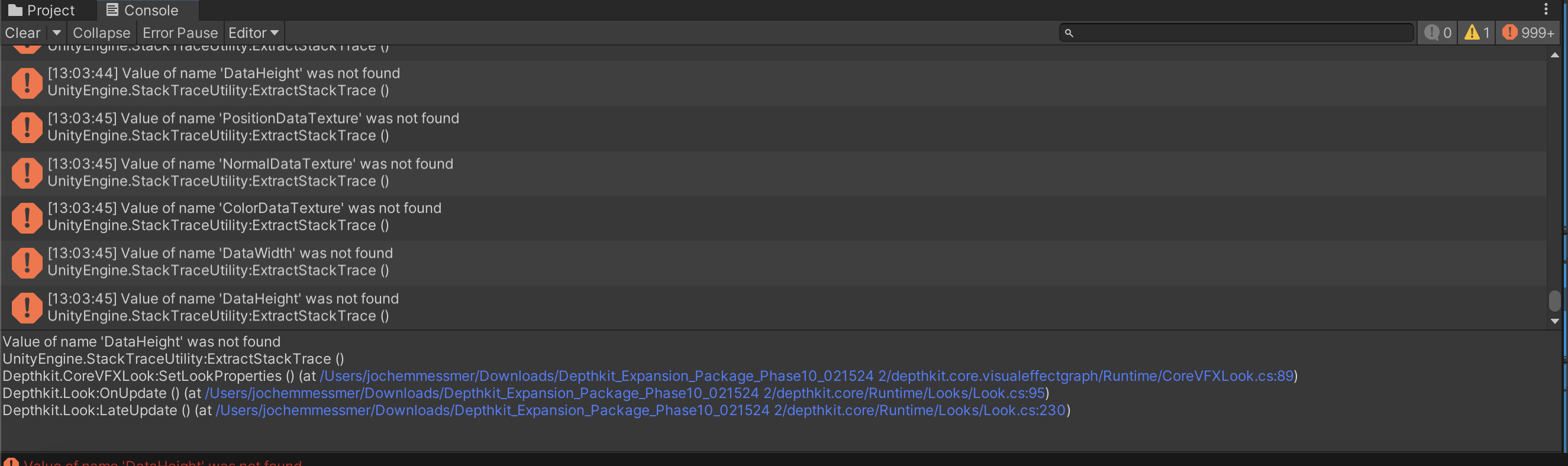

  • Value of name ‘DataHeight’ was not found
  • I’m not allowed to make my own VFX looks under Create → Visual Effects → Depthkit VFX Look. No warnings on screen.
  • In the Inspector under ‘Depthkit Core Visual Effect Graph Look’ the option ‘Script’ is greyed out. I cannot even choose an selfmade VFX Look if I could make one anyway.
How to fix this? 🙂 Thanks for your patience, I’m new to Unity/Depthkit/Volumetric Video in general. I have more screenshots, but I’m not allowed to post them as a new forum user.

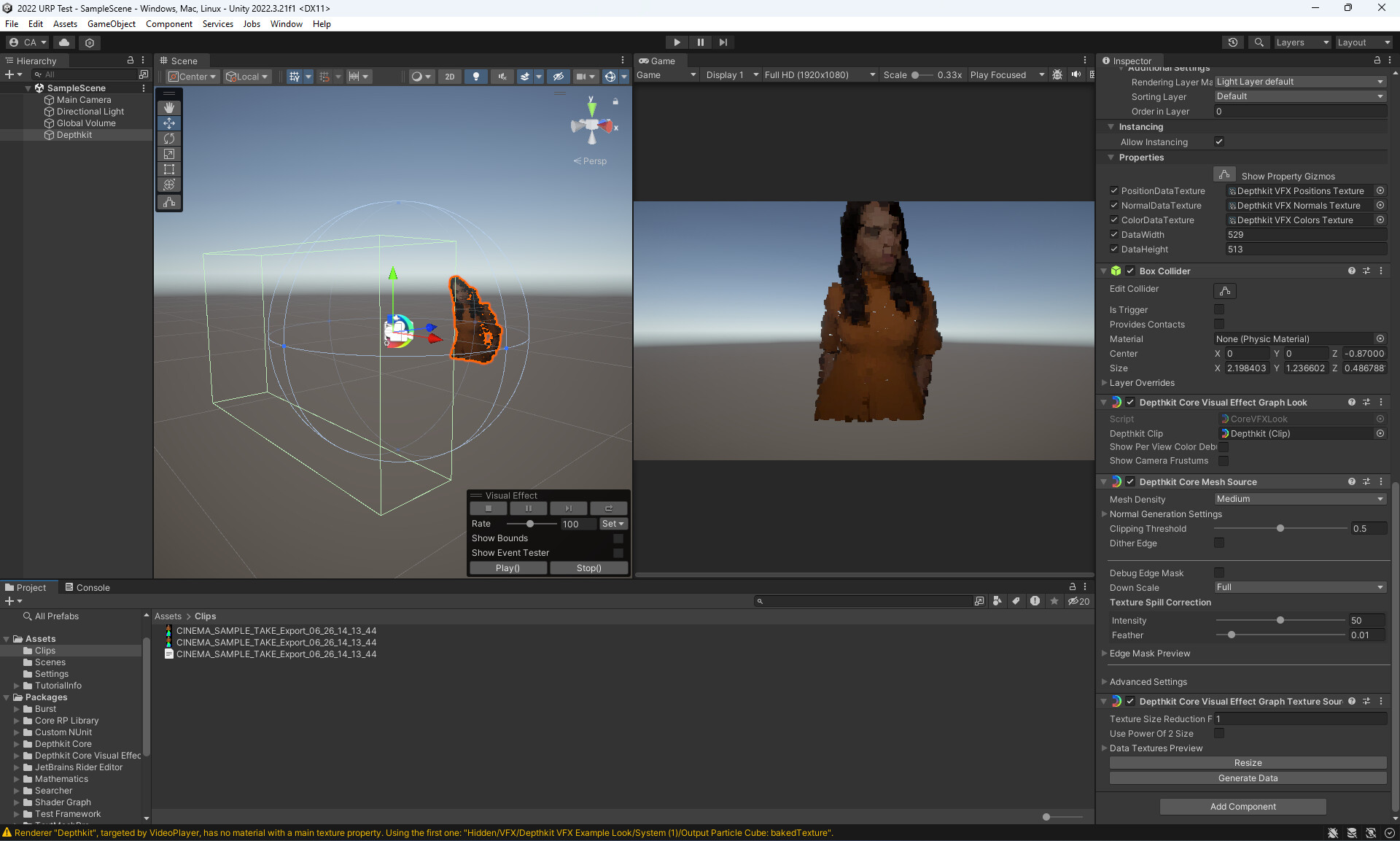

@JochemMessmer I was able to construct a Depthkit Core Visual Effects Look object with the above steps.
Can you confirm the following:
  • Which version of Unity you are using - In the above screenshot, you can see I am using the latest version of Unity 2022 LTS.
  • That your project uses either the Universal Render Pipeline (URP) or High-Definition Render Pipeline (HDRP). Unity’s Built-in Render Pipeline doesn’t support the Visual Effects Graph, which is required for the Depthkit Visual Effects looks, so either of the scriptable render pipelines are required.
Apologies on the single-image per post constraint. If it helps, feel free to share a cloud storage (Google Drive, Dropbox) link with more screenshots / screen recordings to share more about the issue. I’ll keep an eye out.
JochemMessmer Jochem Messmer #7
Hi Cory,
Thanks again. Turning on the URP Pipeline did the trick, don’t know how I missed that. Thanks again!
