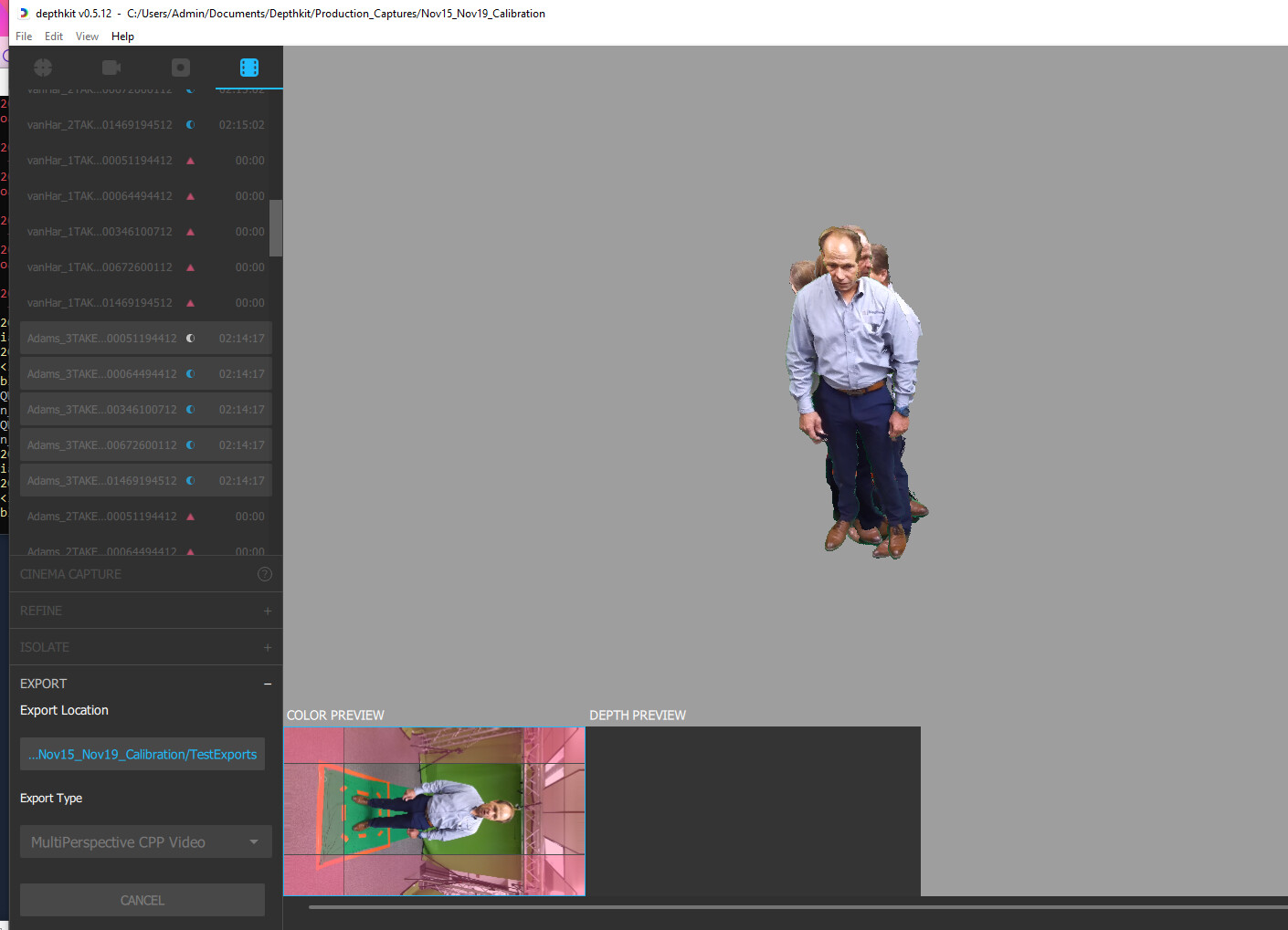

Recently, our team ran into an unfamiliar glitch in depthkit where our previous recordings are playing back as if they were not calibrated. HAving had a concrete understanding that that the captures looked decent originally, it looks as if they lost the information that held together the calibration. By any chance do you know what this issue might be? Below is a photo of this exporting issue. Thank you for your time.

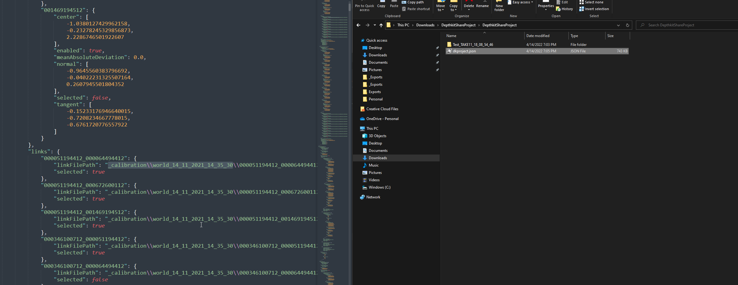

The project file shows that there is a calibration created, however the actual calibration folder is somehow missing from the folder.
Here is what I’m looking at:
Notice that the JSON file shows “links” in the calibration that refers to a folder “_calibration/world_14_11_2021_14_35_30…”
However the folder you shared does not have the “_calibration” folder in it. Just the Depthkit project file JSON and the media example you provided.
You’ll need to track down that calibration folder in order to restore your calibration.

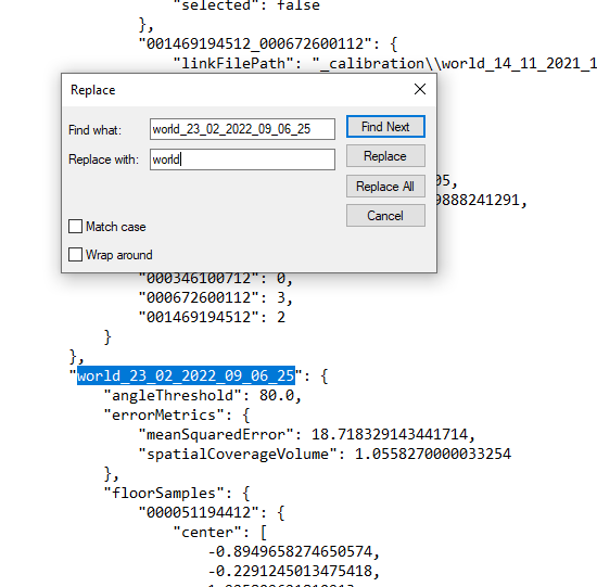

I’ve taken a look at your project file. I see two backed up calibration folders, and I am not sure which one you want to use, but I chose the more recent “world_23_02_2022_09_06_25” to restore. I’ll describe the steps I took to restore it as well.
First, looking at the _calibrations/world directory in your project folder, I see the following directories:
  • world
  • world_14_11_2021_14_35_30
  • world_23_02_2022_09_06_25
As I said, I chose world_23_02_2022_09_06_25, so I’ll use that in this example.
  1. Back up your entire project folder before proceeding!
  2. Rename the current _calibrations/world directory to something else, for example, another world_day_month_year_hour_minutes_second folder.
  3. Rename the folder for the calibration you want to restore to world. In my case, I renamed world_23_02_2022_09_06_25 to world
  4. Open the dkproject.json file in a plain text editor like notepad. (Do not use a rich text editor like Word)
  5. Find the “calibrationLinkMaps” section and then within that, find the “world” section. Rename the current "world" to be whatever you chose as the folder name in step 2.
  6. Use the find & replace feature of your text editor to replace ALL instances of the calibration name you want to restore (world_23_02_2022_09_06_25) with just world.
  7. Save and close the file.
  8. Load the project in Depthkit.
  9. You should now have the ability to “continue calibrating”. Click the Continue calibrating button to force depthkit to update the transformations for each camera. Once you see the calibration points in the viewport, you can stop calibrating again.
  10. At this point your calibration has been restored, and you can export normally.

I am getting an error in which Depthkit force closes when I hit the export button. From the looks of the point cloud information it seems that the calibration is fine. Is there a way to fix this export issue or is it a lost cause?
Thank you for all the help.

@DanielShevelev are you exporting multi-camera combined per pixel video or multi-camera combined per pixel image sequence?
Try image sequence as the sequence may be too high resolution for the video encoder.
Are there any errors reported in dialog boxes or to the console prior to Depthkit exiting?
James James George admin Staff #12
@DanielShevelev Could you please check your Export location in export to see if it’s set correctly?
Do you get the error if you are trying to export a single perspective format or other type?
DanielShevelev Daniel Shevelev #14
Whoops I forgot to hit reply. Yes I got everything working and the export works!
