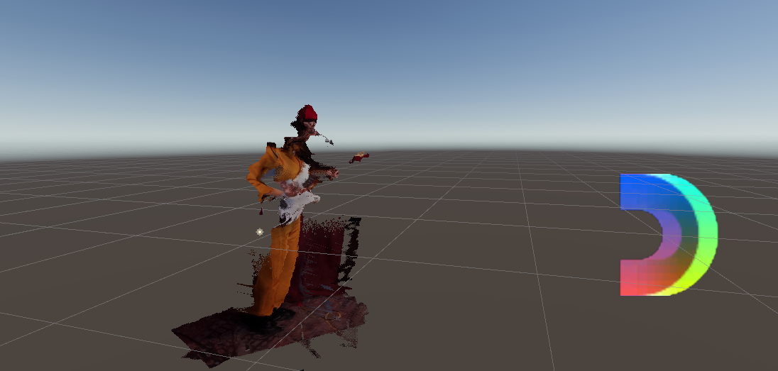

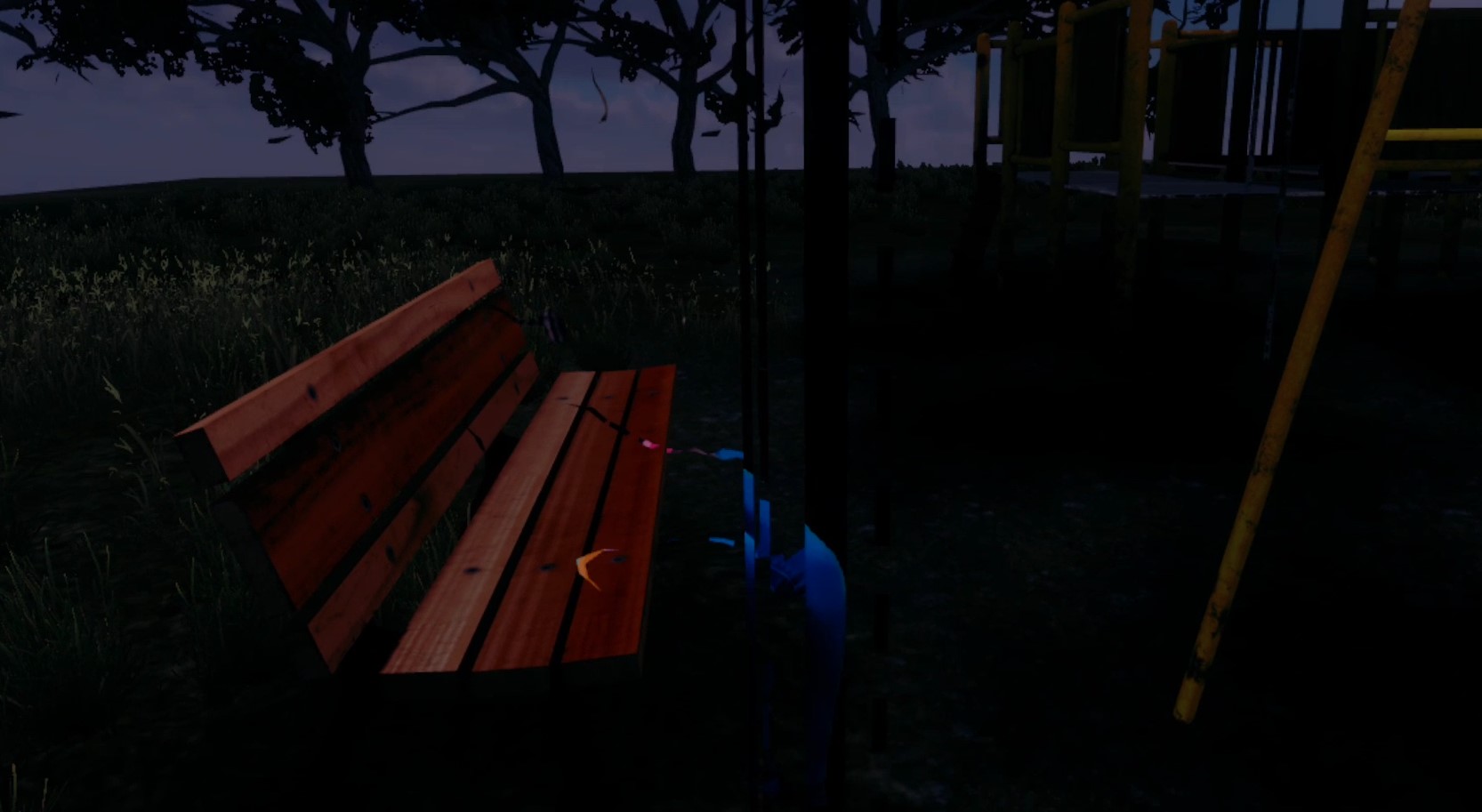

It turns out that a quest that was updated to version 53 has a problem to run the volumetric image – the image appears as a damaged and broken one. On versions 51 or previous the quest runs it perfectly okay
attached please find two screen shots of the same scene –
one with the full volumetric image captured on an older version of the quest 2 (version 51)
the other with the broken image captured on version 53

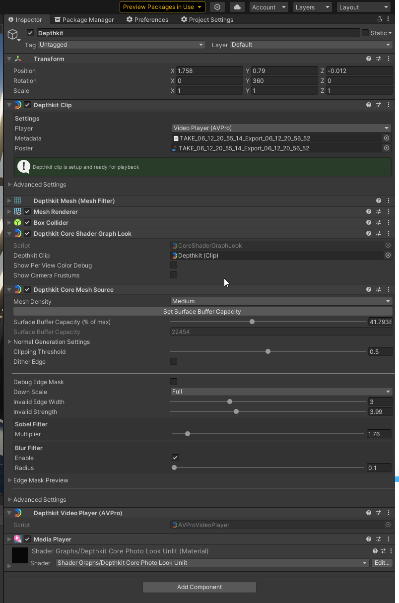

  • Updated Oculus Quest 2 to the latest OS (version 54 as of today)
  • Created a URP project in Unity 2020.3.48f1
  • Added depthkit.core and depthkit.core.shadergraph packages from Phase 8 (Depthkit_Studio_Expansion_Package_Phase8_030722.zip)
  • Imported a Depthkit Core clip captured from Depthkit
  • Setup a Depthkit Clip and Depthkit Shader Graph Look
  • Added XR Plugin and configured for Oculus XR, Android build target, Converted the main camera to XR camera rig
  • Built to Quest 2 and the clip displays normally
  • I then did the same with AVPro (2.1) player and depthkit.avpro and it also worked normally.
A few things to check on your end:
  • Ensure you are running URP pipeline and Depthkit Core Shader Graph Look for the Look Component
  • Ensure your surface buffer capacity has sufficient memory (mine needed to be at 41%). Do this by clicking the Set Surface Buffer Capacity in the Editor when the thumbnail is showing.

See my settings window for reference:

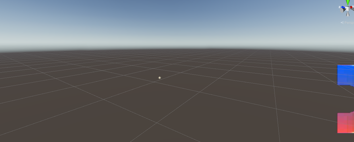

But, with the Core version there’s a different issue that appears in Scene Mode \ Play Mode and Build - you can’t view the volumetric video gameobject if you’re close to it a few meters - only from afar.
Strangely, its visible if you turn the gameobject 180 degrees and view it from behind (which is not what we want, obviously).
