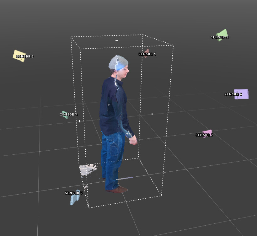

I have been experiencing problems with my captures. After completing an in-depth calibration and getting all the parameters to over 99%, I’m still getting significant separation in the final capture. I believe it might be camera placement, and I would love some feedback. Below are images of the rig, measurements of the camera placement in relation to one another, height from the floor, and downward angle. I’ve also included screenshots from the editor window.
Distance between cameras:
1-2 - 54"
1-3 - 53"
3-4 - 64"
4-5 - 60"
5-6 - 64"
6-7 - 72"
7-1 - 41"
Height from ground:
1 - 82"
2 - 28"
3 - 66"
4 - 29"
5 - 73"
6 - 28.5"
7 - 65.5"
Degrees facing down:
1 - 30
2 - 10
3 - 16
4 - 1
5 - 21
6 - 9
7 - 16
Thank you!

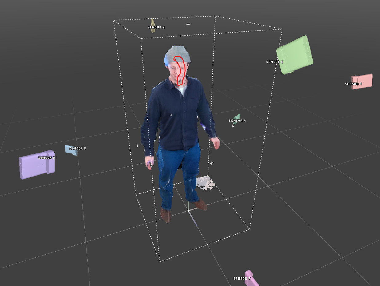

@AlanWinslow Thanks for sharing the screenshots and photos materials. To help others who may be experiencing this same issue, I’ll reiterate what you’re seeing with some of your visuals:
When your subject is facing your hero-position sensor, there is a visual artifact resembling a seam appearing right down the front of your subject’s face. At first glance, this seems especially puzzling because the here sensor (in this case the green Sensor 3 in the Depthkit 3D Viewport) is well-positioned with a clear view of the subject’s face.

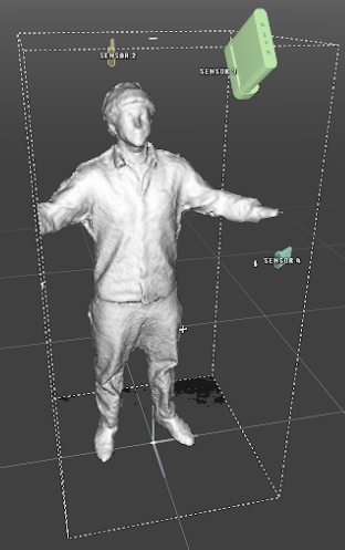

Looking at a shaded view without texturing, we can see that this issue does not appear to manifest in the geometry - The shape of the face doesn’t have any kind of ridge or asymmetry which would indicate geometry misalignment.

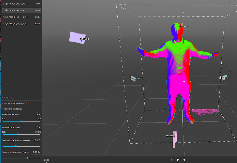

Looking at the Texture Contribution view, which shows the composition of the texturing with color-coding by sensor shows that the green Sensor 3 is only contributing to a small area of the forehead, and that the flanking sensors (6/Violet and 1/Red) are texturing the rest of the face with a hard edge at the boundary of the two - right down the center of the face. This can be addressed in the following ways:
  • The Texture Blending options can be adjusted to soften the boundary between the two textures, specifically by lowering the Fixed Texture Blend value. Be sure to do this while looking at both the Textured and Contribution views to see how this adjustment affects texturing.
  • For Combined per Pixel assets destined for Unity, increasing the Dynamic Texture Blending value will cause much more of the 3/Green sensor to be used for texturing when viewing from the front. Again, do this while looking at both the Textured and Contribution views to see how this adjustment affects texturing, especially when moving the virtual camera around to different positions. These non-destructive settings will be retained once the asset is exported from Depthkit and imported into Unity, but can be further adjusted in Unity in the Depthkit Studio Mesh Source component’s texture settings.
  • After adjusting both Dynamic and Fixed Texture Blending settings, then adjust the texture spill settings below them to reduce and soften texture spill artifacts (e.g. the outline of an extended arm projected onto the chest).
