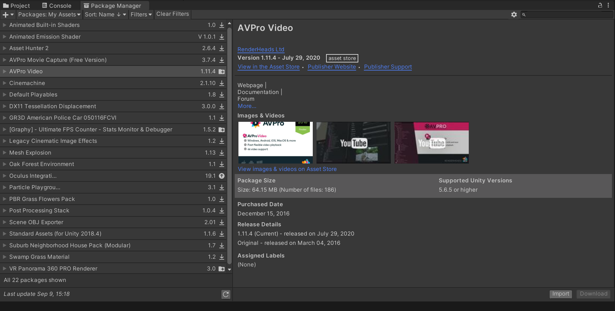

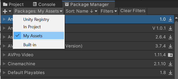

  1. In the Package Manager, in the Packages dropdown menu, select My Assets to view your purchased assets.
  2. Locate AVPro from this list and click import.

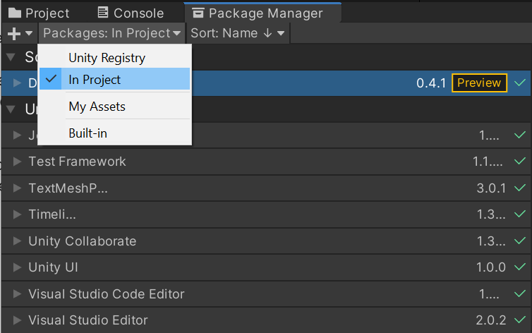

  3. Back in the Package Manager, select In Project from the Packages dropdown menu to import your desired Depthkit Core package if you have not already done so.

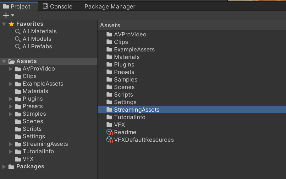

  7. Import your Depthkit asset. Create a Clips folder within your Assets folder. Drag your Depthkit metadata file and poster image into this folder. Drag your Depthkit video into the StreamingAssets folder. This folder was automatically generated within the Assets folder when you imported the AVPro package.

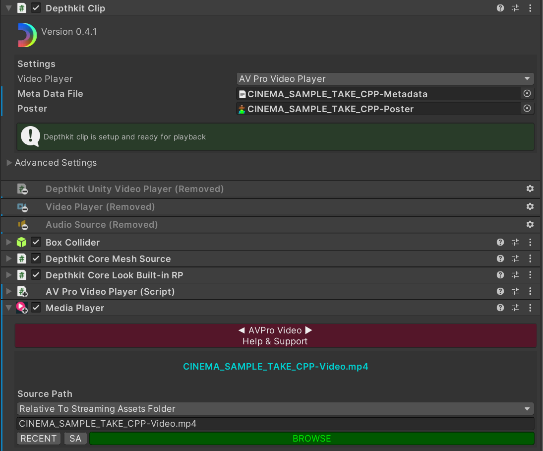

  8. In your assets folder, locate the Depthkit Clip + Core Built-in RP from the Sample folder and drag it into the Hierarchy. Select the clip and see the Inspector.

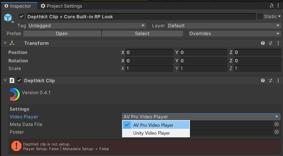

  9. In the Depthkit Clip component, select the video player dropdown and select AVPro Video Player.
  10. Drag your metadata file and poster image to the corresponding fields in the Depthkit Clip component. In the Media Player component, click browse and select your Depthkit video from Streaming Assets. Ensure that the Source Path is set to Relative to Streaming Assets Folder. Now your clip is ready for playback using the AVPro Video Player!
