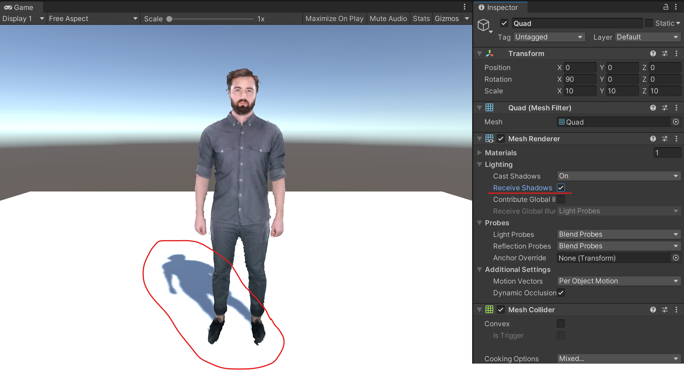

@JavierCampos Which render pipeline are you using in your Unity project? Can you share any screenshots or more information?

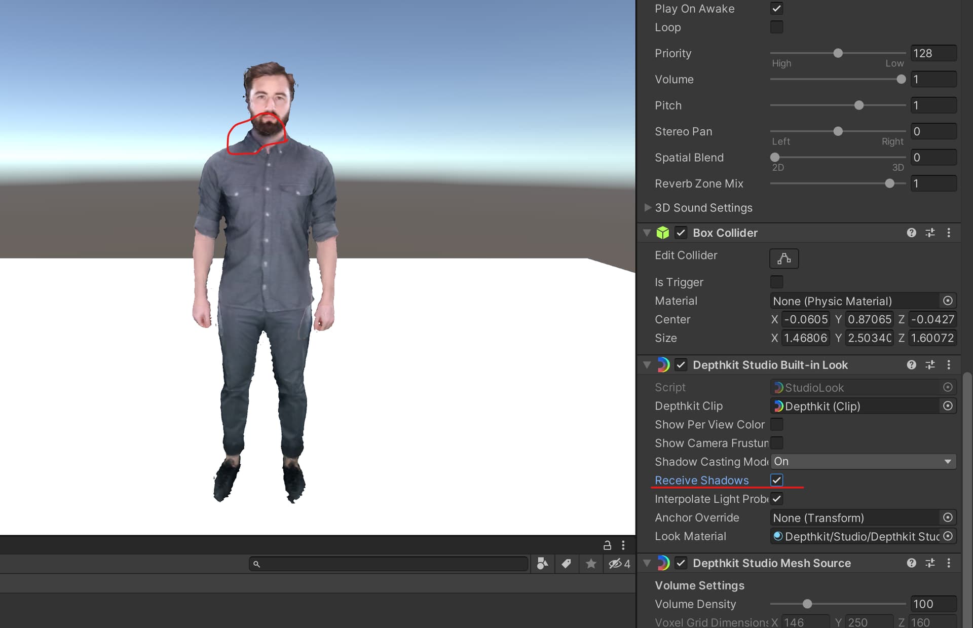

Hi, @JavierCampos. It looks like you’re using Unity’s Built-in Render Pipeline. Though the options for lighting and shadows are limited in this pipeline are limited compared to the scriptable render pipelines, there are still some controls which affect shadows.
First, ensure the appropriate Built-in Look component for the type of asset you are using is attached to your Depthkit object. If you have Depthkit Studio assets, use the Depthkit Studio Built-in Look.
By default, self-shadowing and casting shadows on other objects are enabled.
In the Depthkit object’s Built-in Look component, ensure that the Receive Shadows box is checked to enable self-shadowing.
For any other object that you want the Depthkit object to cast shadows on, make sure that that’s object’s Mesh Render component > Lighting > Receive Shadows box is checked.
