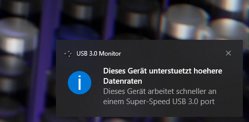

We have plugged in six Azure Kinects into the StarTech PCIe USB ports. After starting the PC with plugged in Kinects or after plugging in a Kinect during runtime, we get an error message that reads, “This device supports higher data rates. This device works faster on a super-speed USB 3.0 port” (translated from German) (see attached screenshot). However, the StarTech PCIe cards provide 3.0 USB ports; therefore, the expected behavior would be that the Azure Kinects could use the full capacity of the USB ports.
StarTech PCIe low data rates

@HS-RheinMain I spoke with StarTech to try to narrow down the issue, and they recommended the following torubleshooting steps:
  • See if you can replicate the issue with any other USB3 devices. If it only appears when using the Azure Kinect, it may be an issue with the USB cables or sensor.
  • Does the message appear when plugging into both StarTech cards, or just one of the two? If just one, try swapping the cards in the PCIe slots and see if the error follows one of the cards, or one of the PCIe slots.
  • Check to ensure the motherboard BIOS, and any other system drivers are fully up-to-date.
  • If you have another PC available, try installing the PCIe cards in that computer to see if it’s an incompatibility between the cards and the Dell computer.
