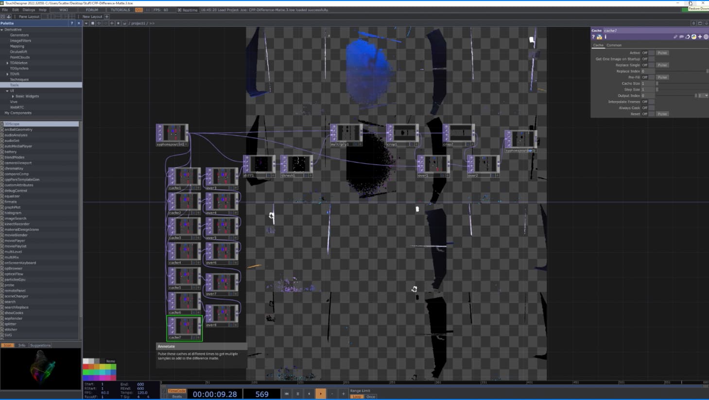

@CornellTech You have a keen eye - We accomplished the background removal through a slight modification to the standard Depthkit Livestream workflow.
Using TouchDesigner (with a commercial license to avoid resolution constraints), we
  • intercepted the Spout stream provided by Depthkit
  • cached a few frames of the stream of just the empty stage
  • blended the frames together
  • subtracted the result from the Depthkit stream’s depth pixels
  • fed that out via Spout to the Unity RenderStreaming sender in place of the original stream
You can find a TouchDesigner project configured to do the above here.
