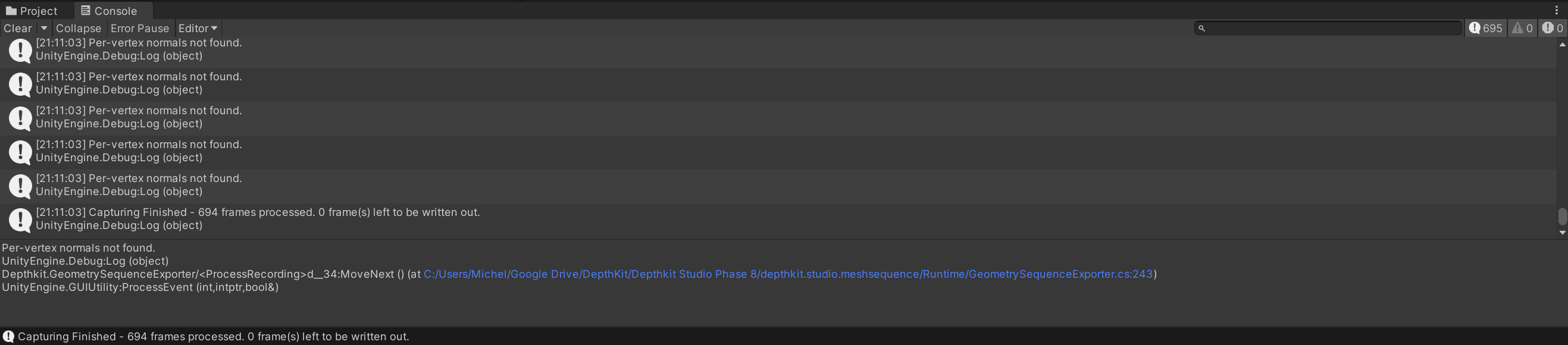

  • Everything is in place and playback was possible. I put the mesh export component in place, pressed play and pressed on the Start Export button.
    I could see how the timeline would go from start to end after which I got the “Capturing Finished” message in the console.
    However when I checked the export output map it is still empty. Attached is my console log.

From the log, it looks like the mesh is not being downloaded correctly which will prevent the system from outputting anything.
It looks like you’re using a scriptable render pipeline, as evidenced by the Depthkit Studio Shader Graph Look component. This workflow currently only supports the Built-in Render Pipeline. Please try using the built in render pipeline and let us know if that fixes the issue.
You may need to rebuild your game object to ensure it is set up correctly for the built in pipeline.
