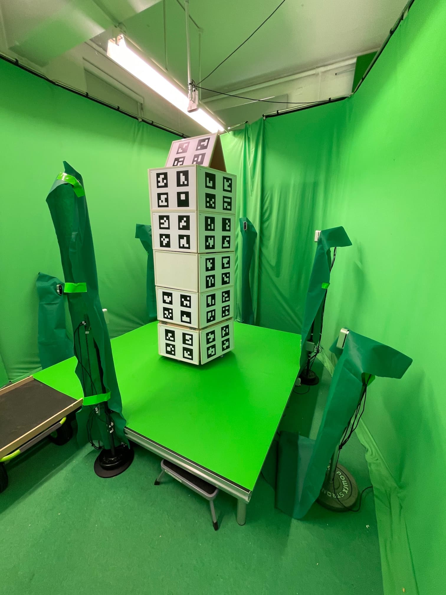

Hi, we have just installed a 10 Kinect volumetric rig and are testing calibration using a 3D marker stand with markers arranged on 4 faces:
When beginning calibration, we started with the markers in the centre of the space. We then moved the markers through the space capturing samples at the corners and midpoints of the edges of the capture stage. As we captured samples, we were keeping an eye on the linked sensors on the Depthkit GUI:

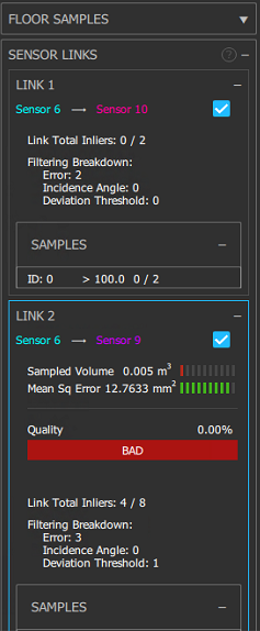

The sensors seemed to link in quite an arbitrary way. They were not linking to sensors adjacent to each other. Has anyone else experienced this when calibrating in this way? Also, after moving the markers throughout the space it took a lot of effort to get all the sensors to link. What is best practice when approaching calibration in this way? What are the specific conditions (eg were should the markers be placed?) to get the sensors to link correctly?

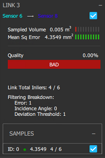

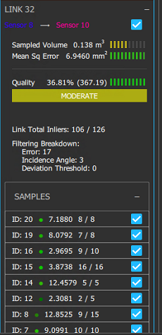

Once all the sensors were linked in some way we continued sampling the volume. As we sampled we made some observations. Firstly, we ended up with 33 links between pairs of sensors. Is this expected? The documentation states that for a 10 camera setup, we should expect samples from 9 links in total. Secondly, most of the linked sensors reported bad quality sampling, whilst some reported moderate quality:
link3
moderateLink

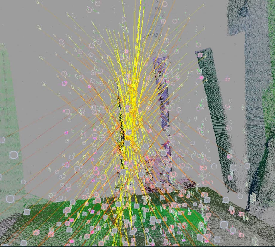

We noticed that the moderate quality link contained a lot more samples that the bad quality ones. Can someone advise the reasons that may lead to bad quality links in this scenario? Finally, we noticed that we were getting a lot of long lines pointing from the samples:
If I am not mistaken these lines represent the direction that the sensor thinks the chart is facing. Can anyone confirm if this is the type of result to be expected from this calibration approach?

To explain the number of links you are seeing, the number of total possible links for a Depthkit Studio calibration is the total number of sensor pairs (1&2, 1&3, … 1&9, 1&10, 2&3, 2&4 … 2&9, 2&10, 3&4, 3&5 … etc.), which in the case of a 10-sensor configuration is (if my math is right) 45 possible links. With most practical sensor configurations, some of these sensors are facing opposite directions, meaning some of the pairs will never be able to see the same calibration marker at the same time, and never form a link. Depthkit gathers samples for all links, and then automatically filters out all but the best links needed to link all sensors, meaning that although you may have 33 links, only 9 (total sensors minus 1) are in use, as indicated by the blue outline surrounding them (see in your screenshots how Link 2 is active, but Link 1 is not). This automatic selection of the best links usually (but not always) chooses adjacent sensors because they usually share samples with the least amount of error, but if there aren’t enough good samples in a link, the calibrator will choose a different one.
The easiest way to see all of the links at once is to hover over the ‘?’ next to the ‘SENSOR LINKS’ header, and a tool tip will show you how each sensor is linked to each other. You can then look up each sensor number’s serial number in the ‘SENSOR CONFIGURATION’ pane to see which sensor number corresponds to which physical sensor, and look for any links which might be causing issues (e.g. a link containing two sensors at opposite ends of the volume).
The long yellow and orange lines in the 3D viewport indicate that based on the current calibration, some of the sensors disagree on where a particular marker was when it was captured, and the longer the line, the larger the disagreement. Ideally, your calibration should make these lines as short as possible - less than 1cm in most cases.
In your screenshot, it looks like the overwhelming majority of the samples you have captured have been filtered out as indicated by the presence of rings to represent the samples rather than dots, which is probably what is causing things to misalign.
  • Do these lines go away (and do the point clouds from each sensor better align) if you open up some of the filters to be more inclusive?
  • What is the best overall Quality you’re able to achieve after adjusting the slider positions?
  • What is the overall Sampled Volume when the quality is the highest?
  • What numbers are being reported in the overall Filtering Breakdown?
Although your calibration object is able to put many markers in front of the sensors at once, many of the markers may still be excluded by the Angle of Incidence filter if they aren’t squared up enough to a pair of sensors. However, if the filters need to be opened up too much, they will start to include low-quality samples, which will throw off the calibration.
In your photo of your calibration object, the two sensors on the near-left side of the stage have a great view of many markers on one side of the object, however, this is not a good position to link those two sensors with either of the mid-level sensors flanking it, as both flanking sensors are seeing that side at a shallow, glancing angle. If you rotated the calibration object ~30 degrees, both the near-left sensors AND the flanking sensors would have a good view of common markers. Make sure you are factoring this rotation into your calibration sample positions.
