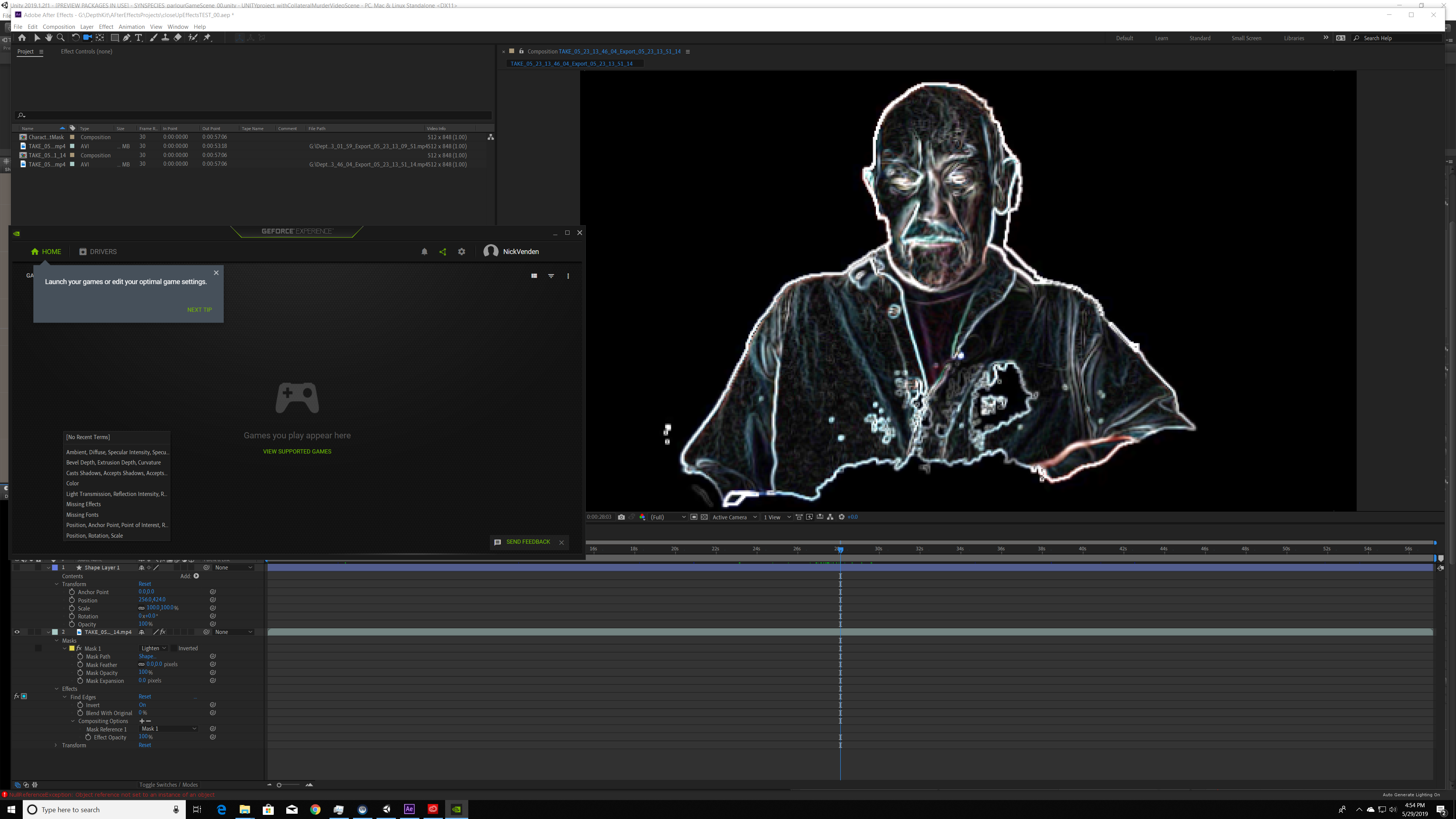

A tip I’d like to share:
I took DepthKit’s 512x848 MP4 into a After Effects comp, created a mask for the top half of the image, applied the “Find Edges” effect only to the mask (by using that top-half mask as Mask Reference in Compositing Options). This new mp4 in Unity without the Zero Days renderer was like a weird reptile skin with interesting color-banding at the edges.
Try it,

Would love to see a photo of how that turned out!
Here’s a quick video clip from the VR headset:
[DepthKit and AfterEffects TEST]
(https://vimeo.com/339244734)
Comments in the Vimeo posting.
The reptilian skin was only a Find Edges filter in AE. However, I had to mask off the bottom of the 512x848px video. This project is in a very early stage of development.
Love it! Can’t wait to see more!
