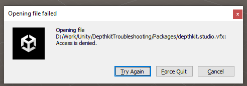

So, first up, when adding the Depthkit plugin packages to the project, Unity seems to have some serious trouble importing both of the VFX files, bringing up this error regardless of what order I add the secondary packages in.

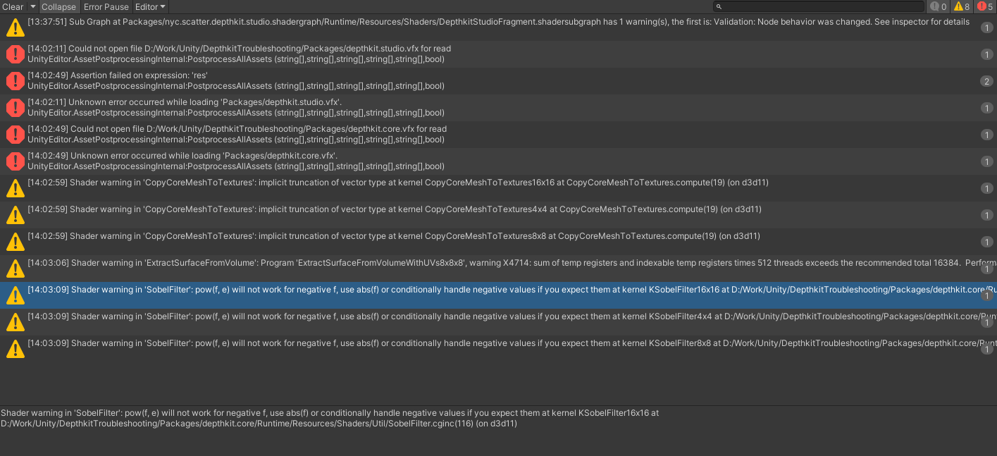

‘Try Again’ doesn’t work, so after Cancelling I get these messages in the Console:

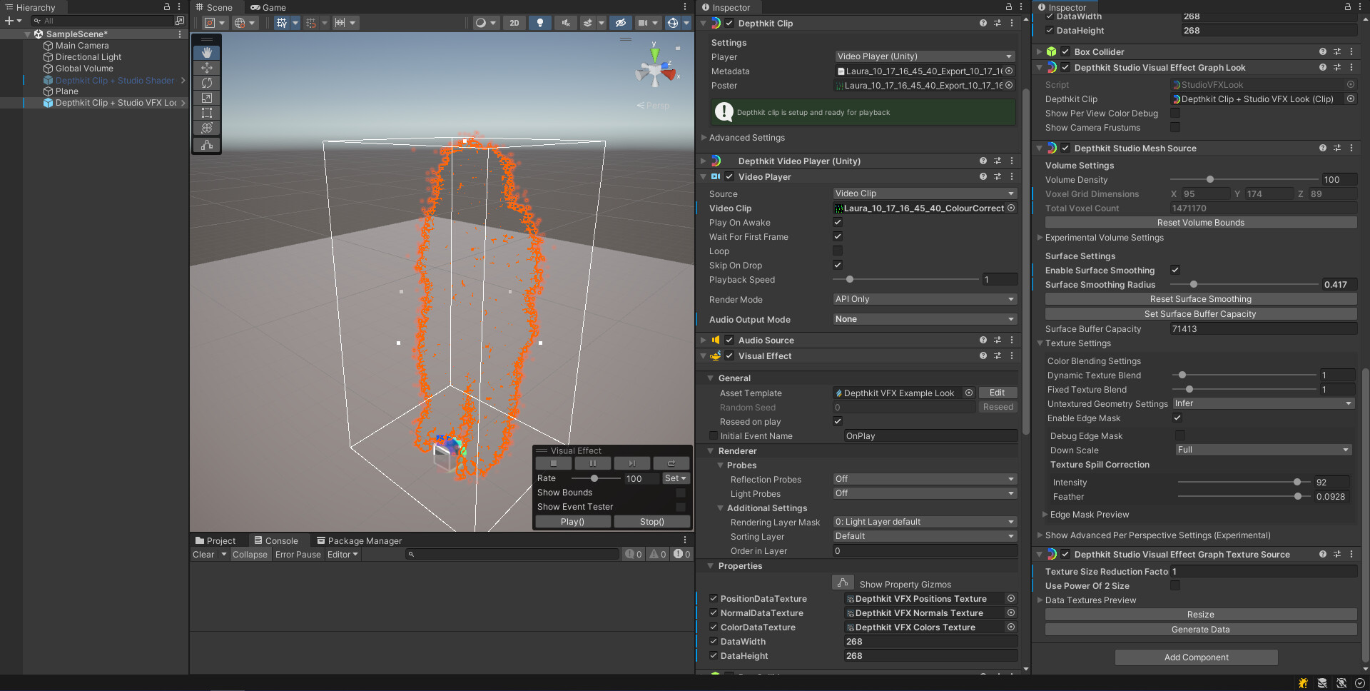

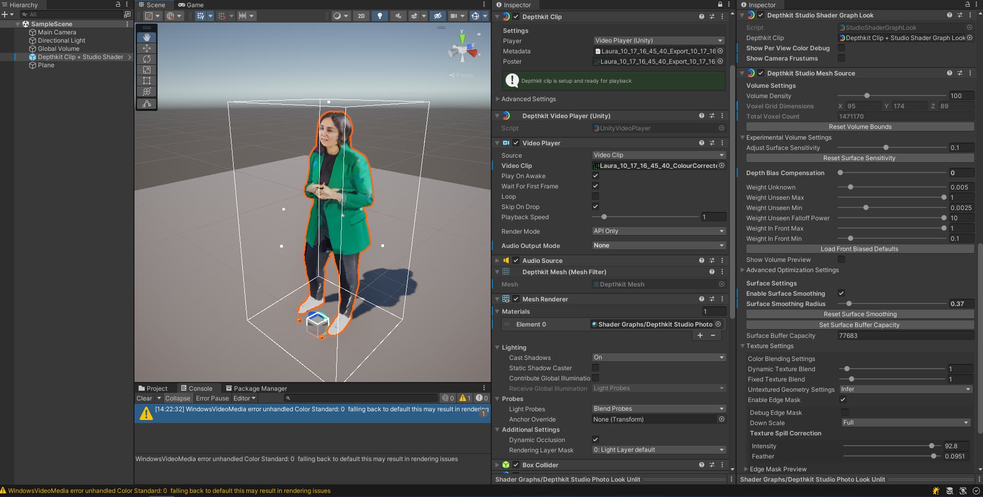

Now I try importing the plugin prefabs, intending to keep most of the default settings unchanged other than the usual adjustments to the Mesh Source to make sure the whole mesh renders in and looks decent.
The Studio Shader seems to work well (barring one odd warning), and plays the recording just fine, though here are my settings for posterity:
However, the VFX plugins don’t seem to visibly render anything in. The particles are still animated, and seem to move away from where the recording’s main body would be, which matches what the default VFX Look should be, however the entire thing is completely invisible other than the selection outline.

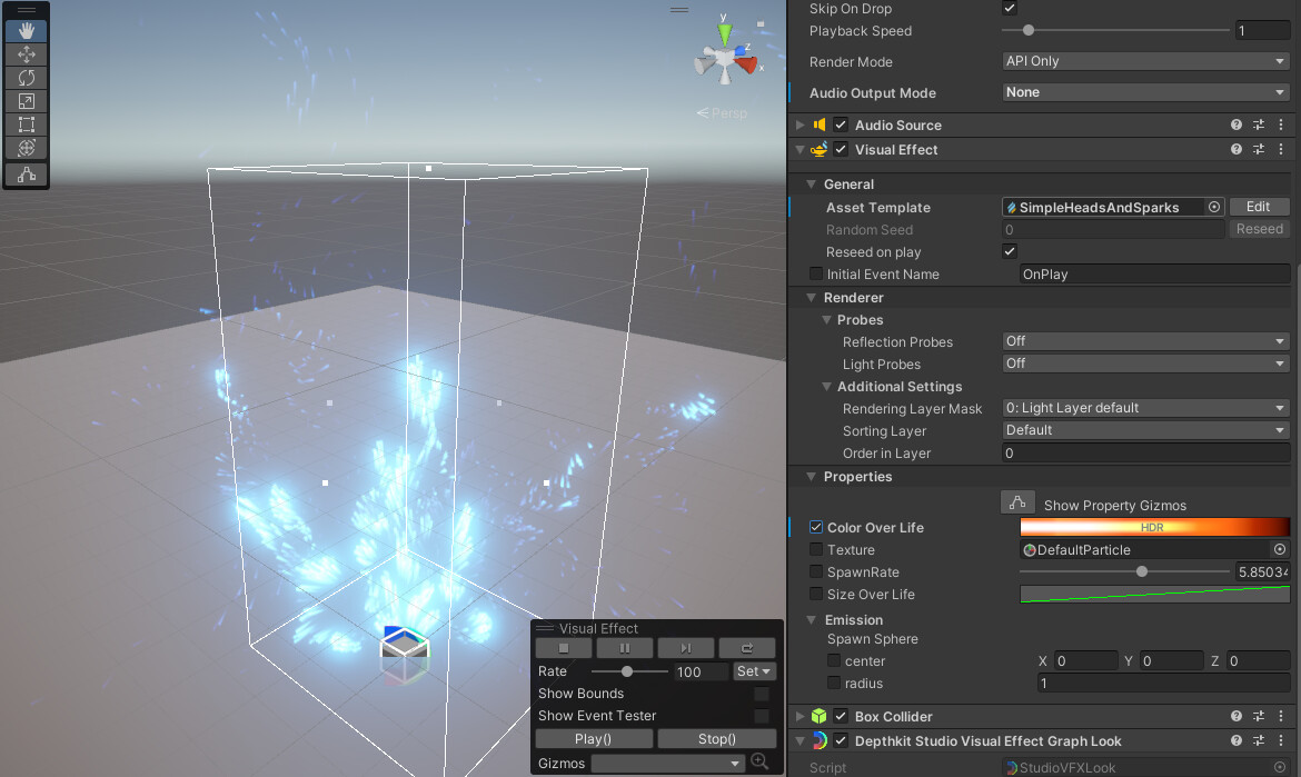

Other pre-made VFX settings still seem to work, such as Heads And Sparks, Swarm Particle System, Heads And Trails, etc., but nothing that seems to have anything to do with the recording.

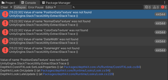

And changing to any VFX setting other than the default VFX Example Look throws these errors on repeat:
I did all this from a fresh URP template project, but these were the same errors I was getting on a different URP project I was working on for a client the other week. As I said at the start, these issues went away when I swapped to Depthkit’s recommended Unity 2020.3 (Other than the Sobel Filter warning for some reason, but that was ignorable). I don’t know if these same issues would happen in Unity 2022.
