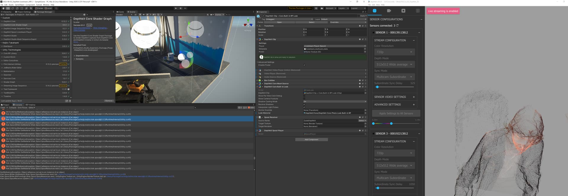

@CoryAllen at Zu we got the Live stream working in Unity 2020.3.33 with Built-in renderer just great (screenshot 1) but for some reason we are getting Console errors and no luck with Unity 2020.3.33 URP (screenshot 2).
Both times we used the Studio_Expansion_Package_Phase-8 and Keijiro’s KlakSpout.
Any ideas?
Thanks in advance!
@VeroniqueLevert The scriptable render pipelines (URP, HDRP) require the Core Shader Graph and Studio Shader Graph plugins. Once both are installed into your project, swap the Built-in Studio Look component out with the Shader Graph Studio Look component to render your livestream asset.
