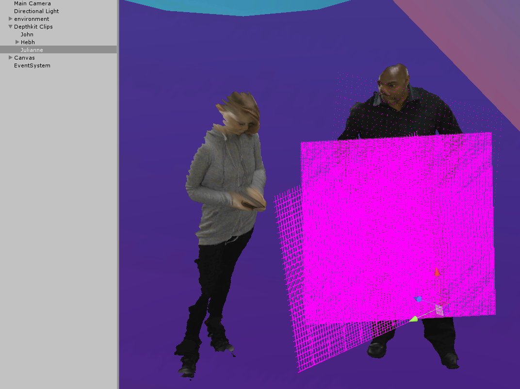

I’m playing around in the demo scene and seem to be running into what looks like a material error in Unity.
There is just a pink box above my clip that I can’t seem to have get rid of (image below). Any advice?
Hi @Izzy, great question!
These errors show up on the Zero Days Look for a few different reasons. If you are publishing to iOS / Mac or Android it could be to do with your graphics settings.
In the Troubleshooting guide on the docs there are some helpful hints: https://docs.depthkit.tv/docs/unity-troubleshooting#section-publishing-platforms
Let us know if this resolves the issue. Good luck!
