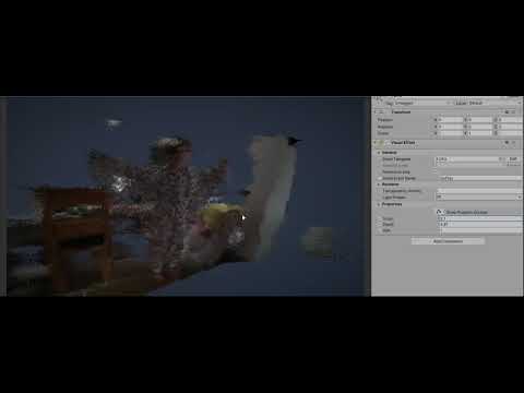

This is using most of code from keijiro/
but using the standard Video player in Unity instead of the HAP
Using the Universal render pipeline & VFX graph. Still some things to sort out.

Hey @AndrewWhitney this looks great. I would love to get this working! I’ve been trying to get Kejiro’s unity project to work, but it seems to be missing scripts for me… Did you have to change anything from from his github repo download other than the manifest file?
AndrewWhitney Andrew Whitney #4
Hi there - nope just downloaded the https://github.com/keijiro/Dkvfx
This worked out of the box - what I wanted to do was to get it working with the standard VideoPlayer & native .mp4 that Depthkit outputs. That took some poking around to do - but mainly just replacing the HAP player. I’ve still got to strip out some stuff but haven’t had a lot of time to play lately.

Awesome! Is there any chance you could share the project? Would love to have Depthkit’s native .mp4 working in VFX graph without needing to convert to HAP.
AndrewWhitney Andrew Whitney #8
I’ll have a look - it’s quite ‘hacky’ how I’ve done it but if it will help.

Thanks so much for sharing Andrew! I’ll give it a proper test later, but just opened the project and it’s working fine in Unity 2020.1 on macOS. Cheers!
