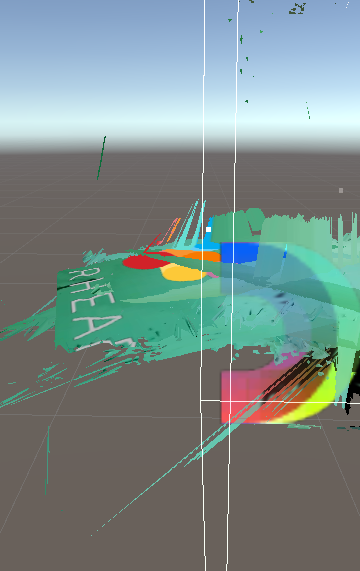

Volume Bounds not clipping scene
2 posts · 176 views
DanielShevelev Daniel Shevelev #1
The volume bounds are not working when trying to livestream via CDN with AVPro. Any reasons this could occur?
Hi @DanielShevelev ,
Based on the nature of the artifacts here, it looks like you may have a Depthkit Core Look setup visualizing a Depthkit Studio asset.
Can you look at your Unity scene and confirm you are using just one Depthkit Studio Mesh Source and Depthkit Studio Look and that there are no instances of a Depthkit Core Look or Mesh Source on the clip?
