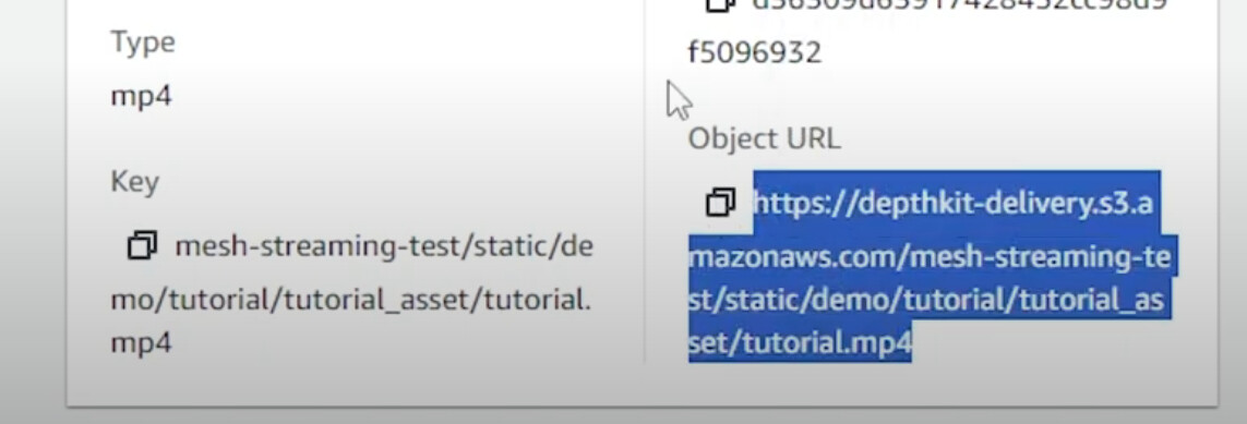

@SICSPACE At 9:06 of the tutorial video, I show that the object URL that you copy from your AWS object needs to be modified before you paste it into the 8th Wall code. This includes removing the .mp4 extension from the end, and separating the object name (“tutorial” in the video) from the rest of the URL.

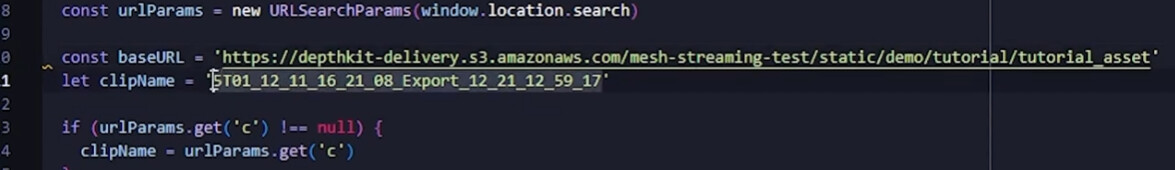

2BT01_Draco_v02 is the name of the example object provided in the 8th Wall template, and corresponds to the name of the MP4 and Draco folder hosted in our AWS cloud. To replace it with your own captures, you need to delete the reference to our object, and paste the URL and clip name of yours in its place (as seen at 9:19 of the tutorial video).
