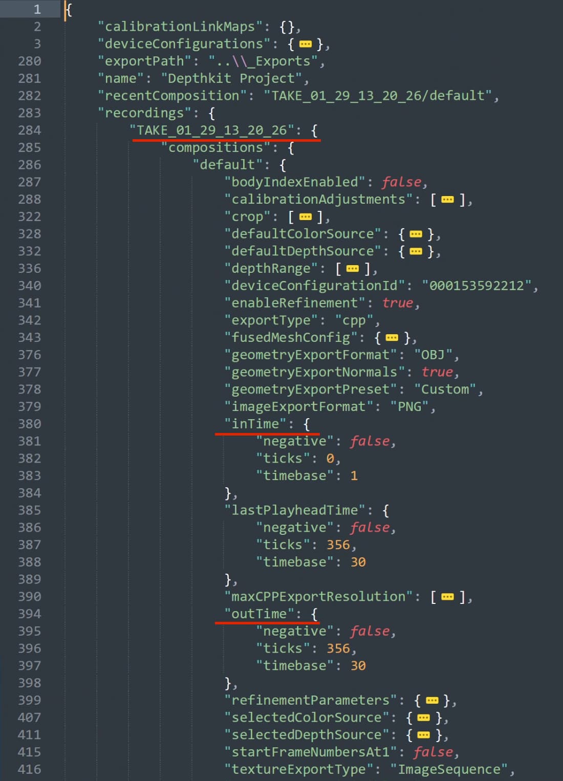

  4. Use a text/code editor to open the dkproject.json located in your Depthkit project bin.
  5. Locate the recordings object. Within that, the locate take object you’d like to edit, and within that, locate the inTime and outTime objects.
  1. Change the ticks value to the frame number you desire, and the corresponding timebase value to 30 (representing the FPS framerate of the capture footage)
  2. Save the JSON, and re-open your Depthkit project. The In and Out points should now reflect the frame numbers you entered.
