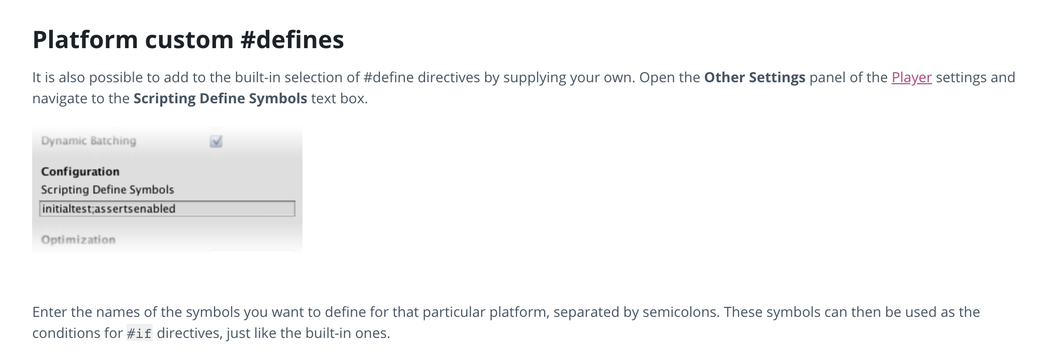

Happy to know things are running smoother! I think one thing that may make the look go away, especially if you imported a new package like AVPro, is that you lost of Unity define that turns of the ZD look. Go to the scripting defines symbols of your player settings in Unity:
Make sure in this list of defines you still see DK_USING_ZERODAYSLOOK in the list. If you’re using AVPro you should also see DK_USING_AVPRO. Make sure these are also present in the the defines for each platform as well, which you can select using the tabs at the top of this editor window.
