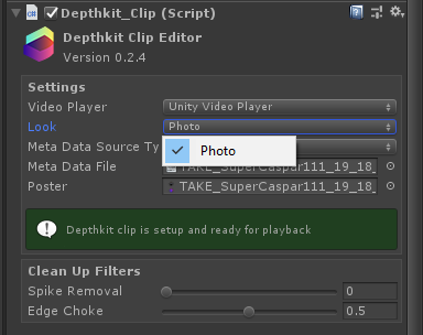

After we import the Zero Days Look into Unity, it shows up in the assets folder, but it doesn’t show up in the inspector window under the settings. Zerodays
Any idea why this happens? Otherwise, we can’t use the look.

Hey Pakinam! When you imported the Zero Days package, did you run into any errors? Try removing the whole Depthkit folder, and import v0.2.5. Then import the v0.2.5 Zero Days Look. Both will be available on the downloads page.

Echoing what @Jillian said, you’ll need to use the 0.2.5 version of the plugin for the Zero Days look to work.
